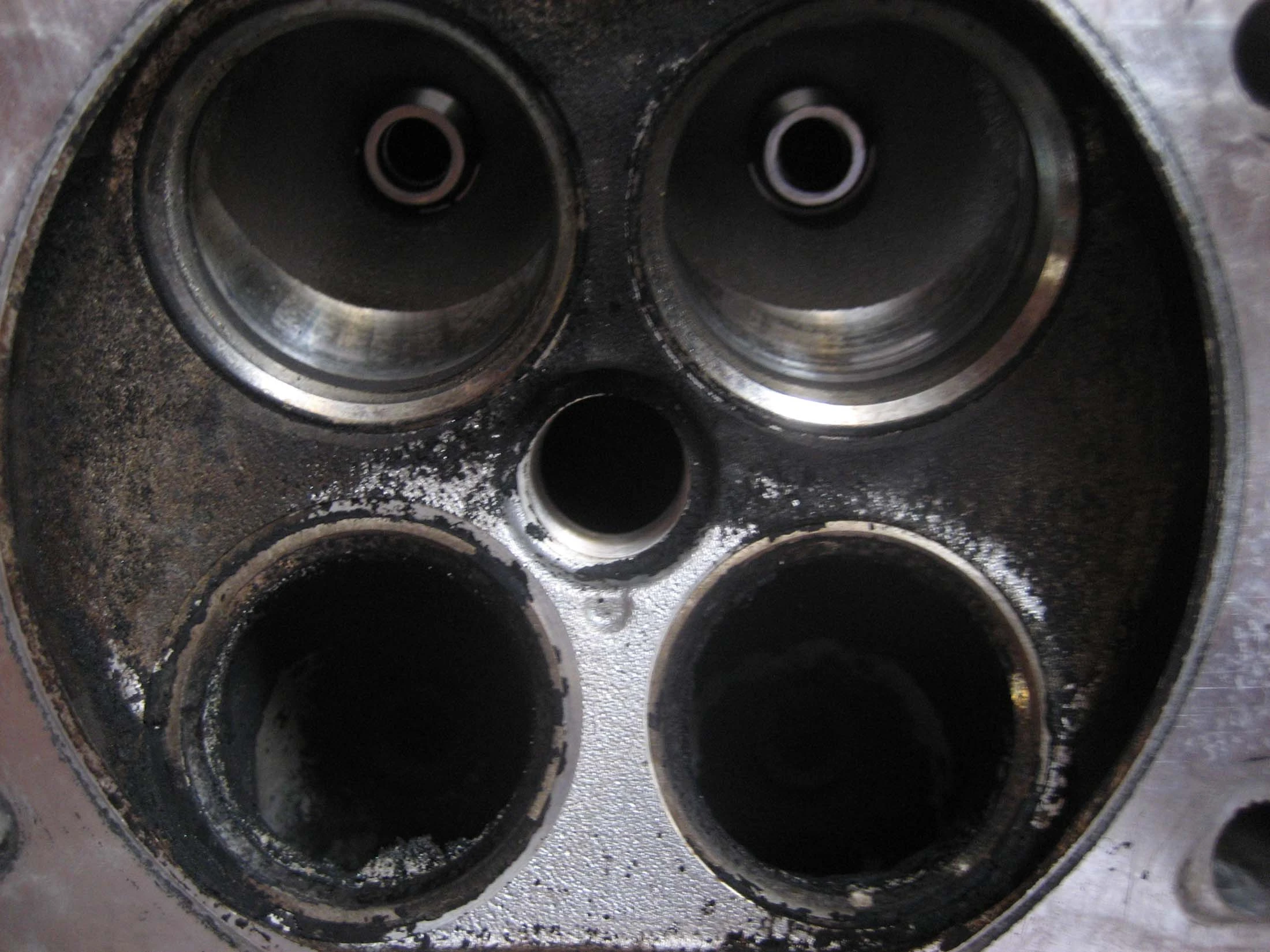

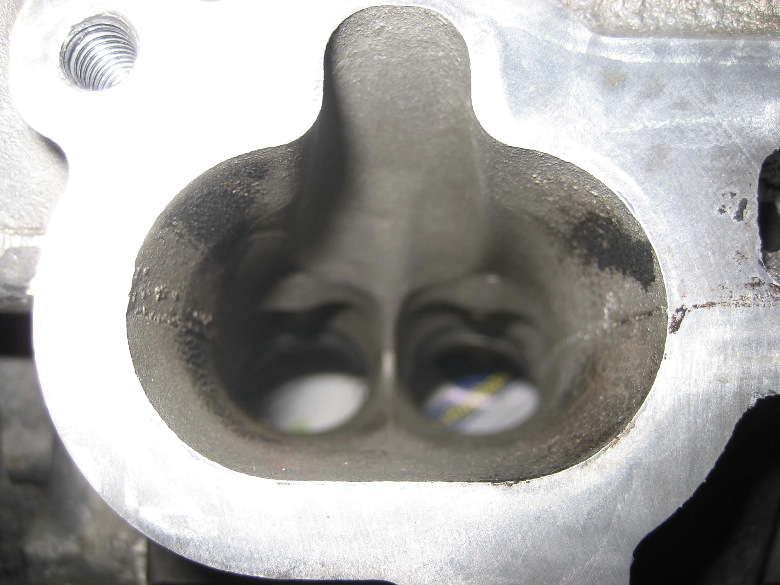

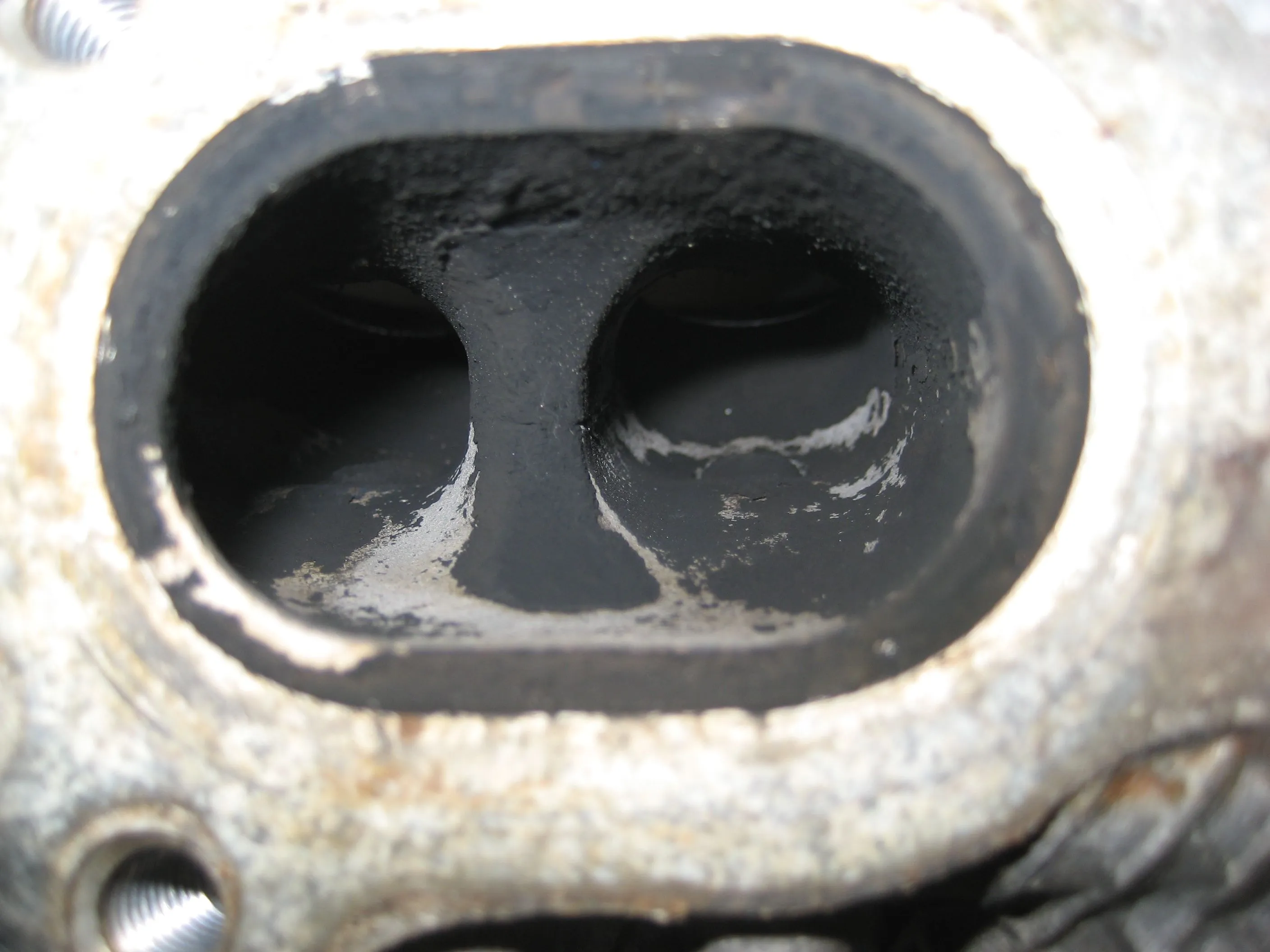

The first three pics are of my head before being sent to Ken and Protege Garage for a port & polish as well as a 3 angle valve job. (top of the cylinder, exhaust port, intake port)

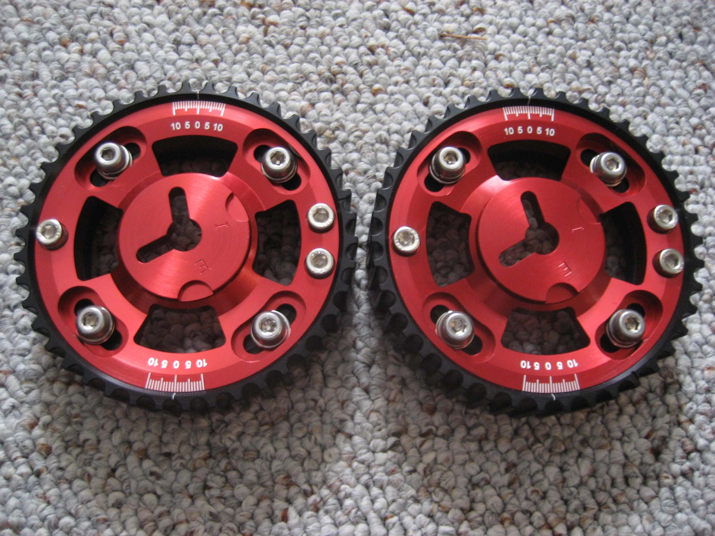

The fourth pic is of the sweet adjustable cams gears I got from kasmankk here on the forums. Red ftw!

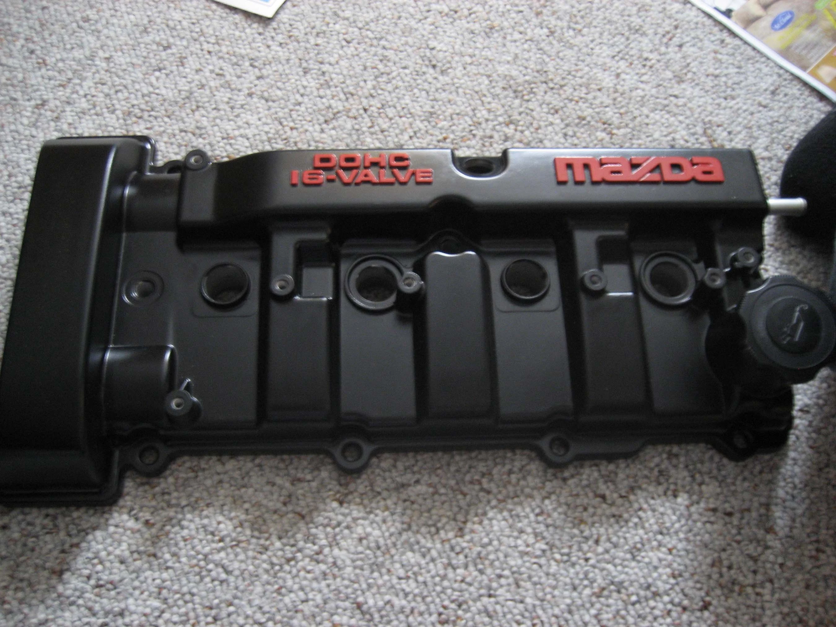

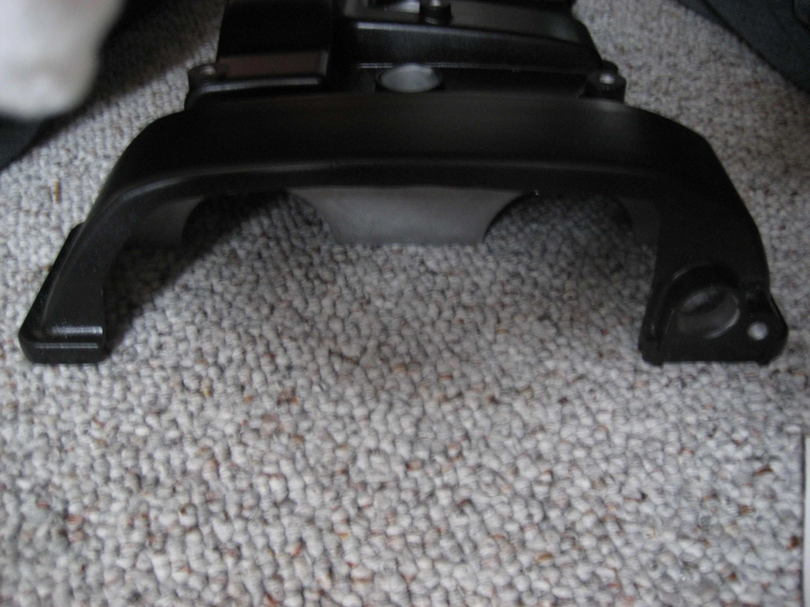

The first two pictures are of my painted and cut valve cover. I used 500F engine enamel (low gloss black and Ford red) on a freshly sandblasted and cleaned valve cover. The cut away will allow me to tune the items in the last pic easily!

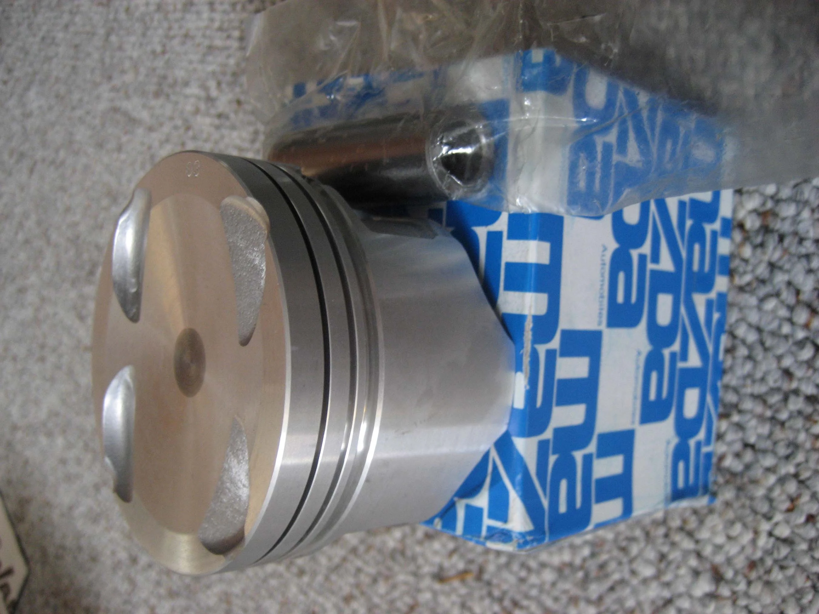

The third picture is a beautiful 10.4:1 j-spec piston

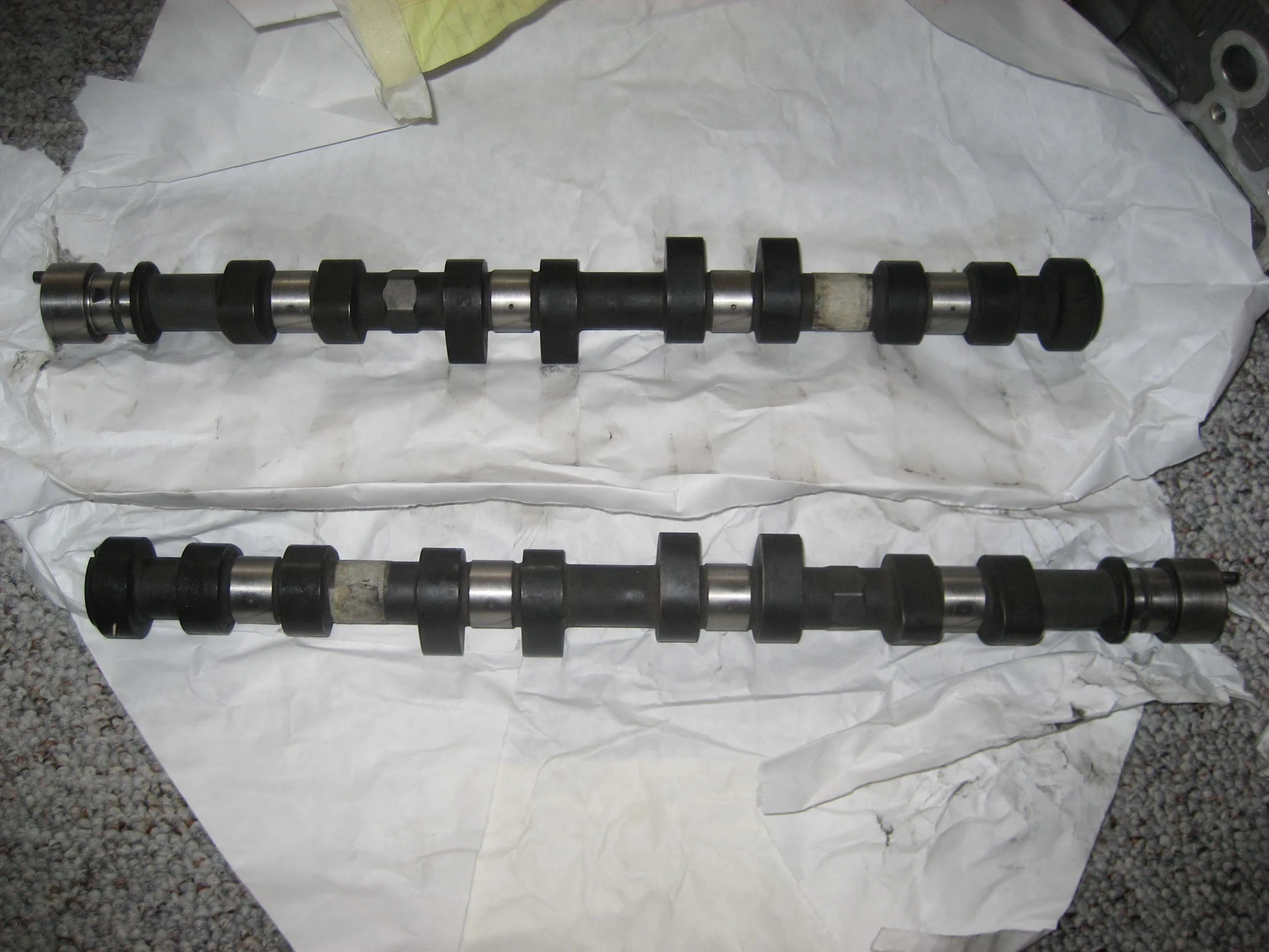

The fourth picture are a set of custom Twiggy cams. One set of, oh... about 20 in the whole world!!!

Sweet to see you started a thread as well. A couple questions for you. Are you still using the same kind of pistons you sent me? Also what did you use to cut your valve cover? A cutting wheel?

used an air tool with a cutting wheel and a dremel with a sanding drum. Not perfectly straight but good enough for me!
Yes same pistons, I bought the ones I sold you thinking they were the 10.7 mazdaspeed version.... they weren't.

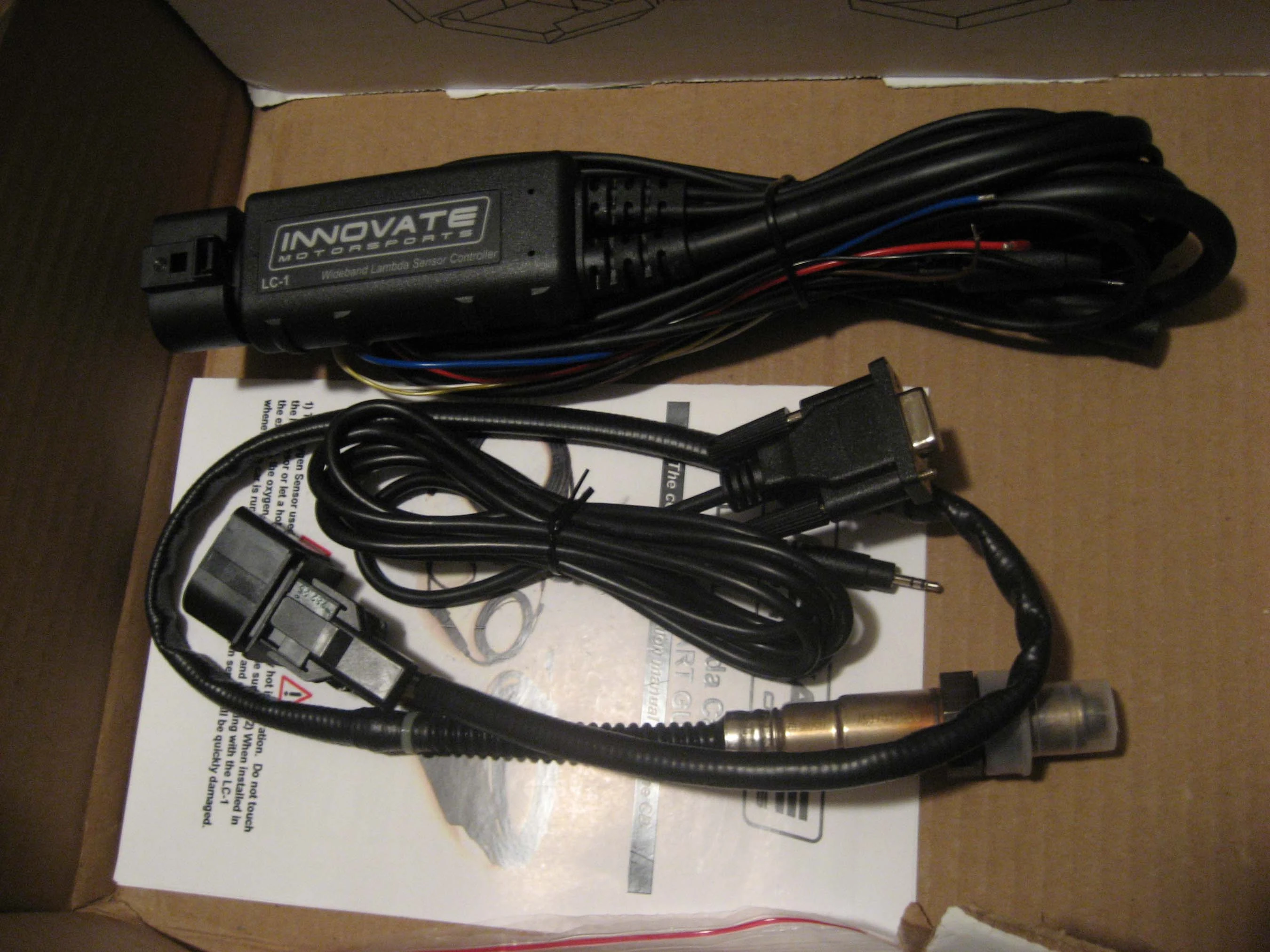

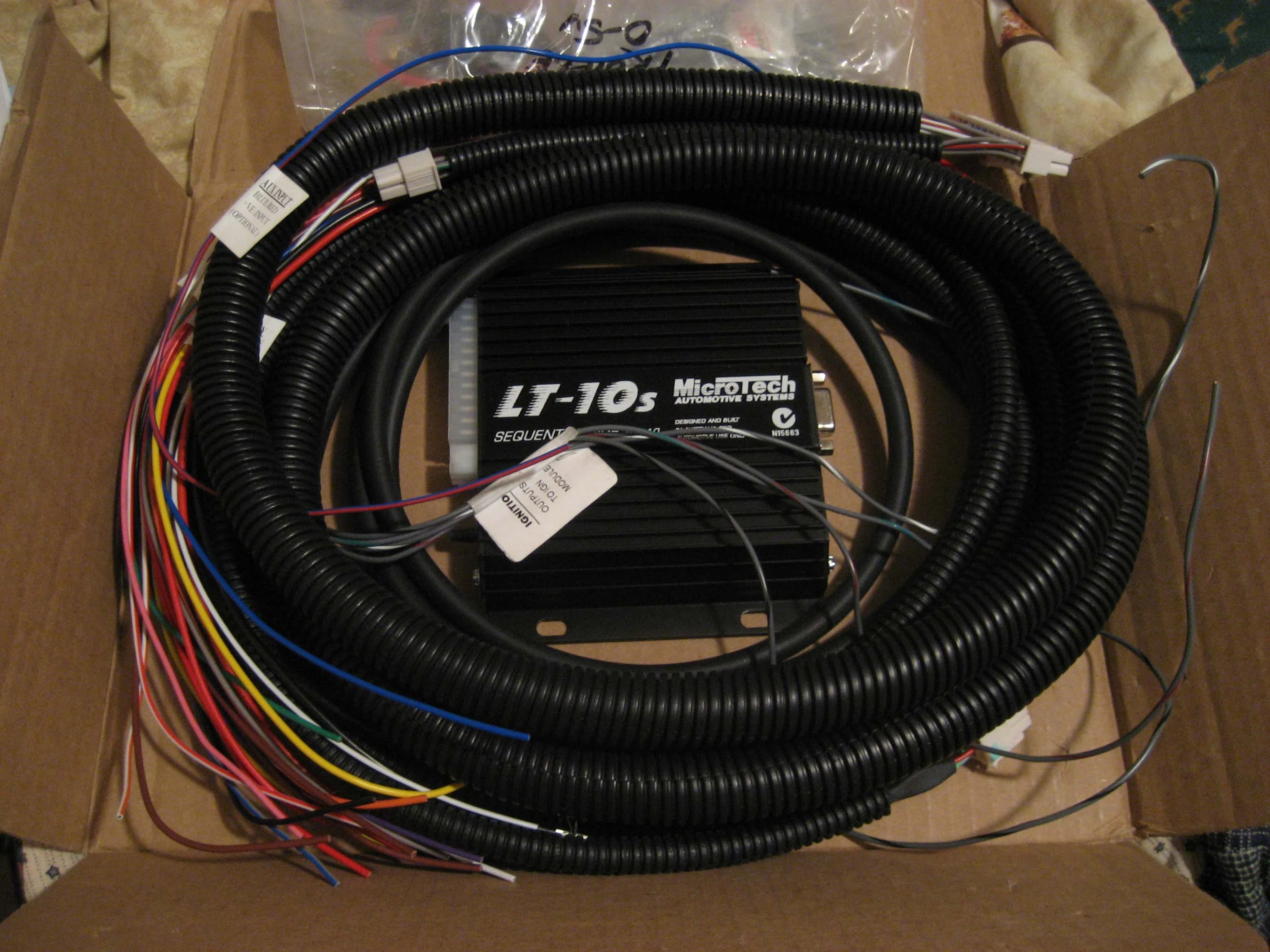

Saved the best and most important for last..... Probably should have had standalone in for a while now but better late than never.
First pic - Microtech!
Second pic - Wideband! Innovate LC-1
