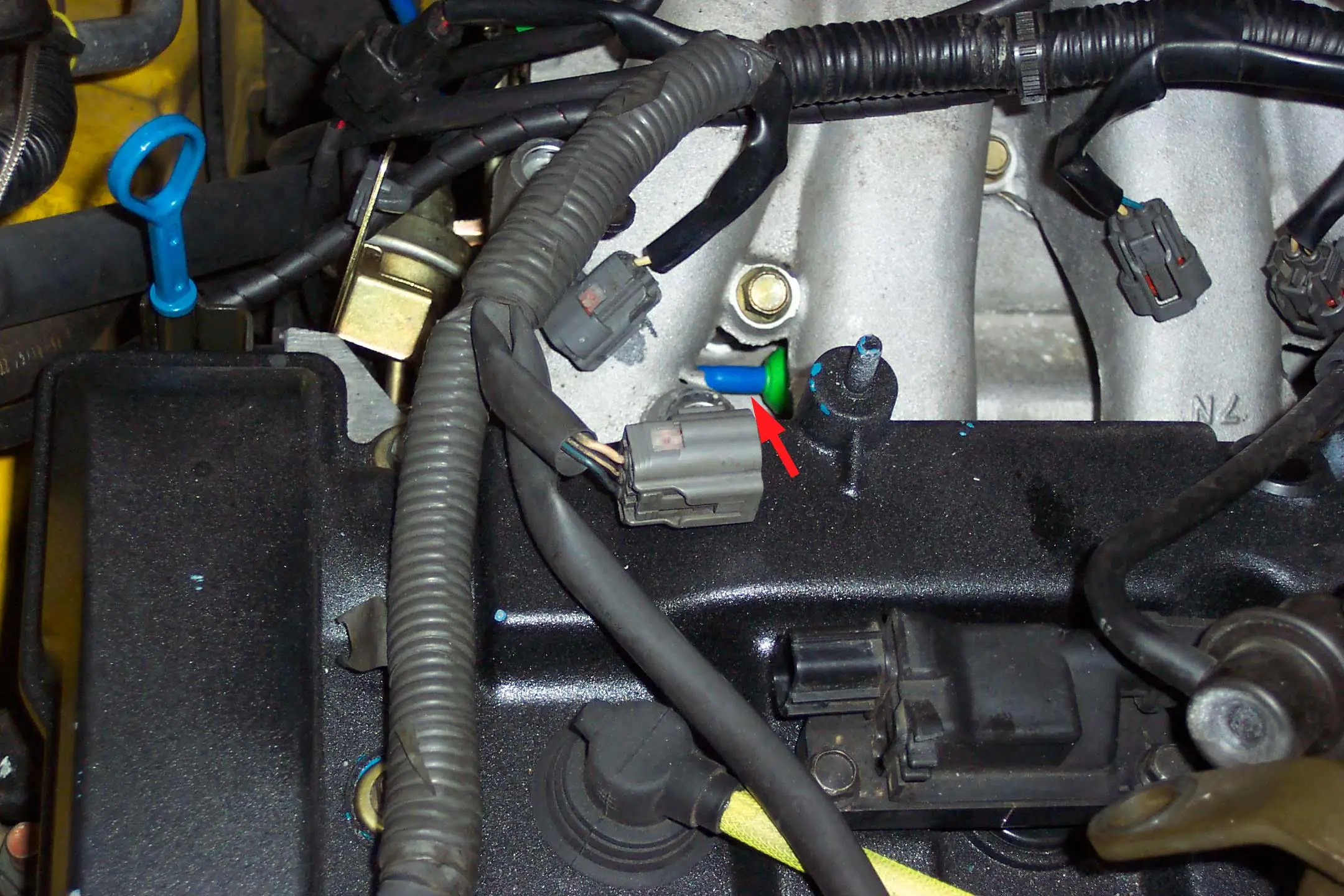

Yesterday, I changed out my plugs. The plugs that were all in there looked fine, with the exception of Cyl 4 (the driver's side plug). It had a green tinge on it which makes me think it was detonating.
Today, I pulled out all of the injectors and cleaned their seats, etc, just to make sure it was all ok.
While I had the fuel rail off, I noticed that there was a vac line with a slight rip in it, which I replaced with my fancy blue vac hose. See the attached pic with the red arrow.
