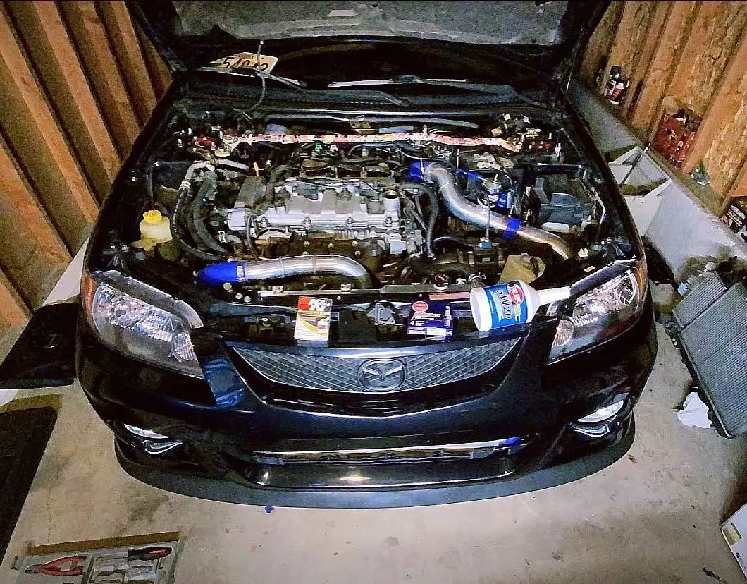

So I’ve had the same code be thrown multiple times over the years in my 2003 Mazdaspeed protege. I have a CXracing FMIC kit and a greddy blow off valve. I gave up after looking for the issue and took it into my trusted mechanic and was told it was because of the blow off valve? Basically just releasing pressure into the atmosphere? I don’t believe this is true. But he also doesn’t specialize in modified cars. I have replaced a number of parts over the years and it will go away for a long time and then re appear. Is this something you ever found the answer to? I haven’t done quite the extensive research on mine as you did to yours. It also drives completely fine and only occasionally throws the code so it hasn’t been too much of a pest. Any help is much appreciated.
