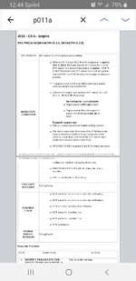

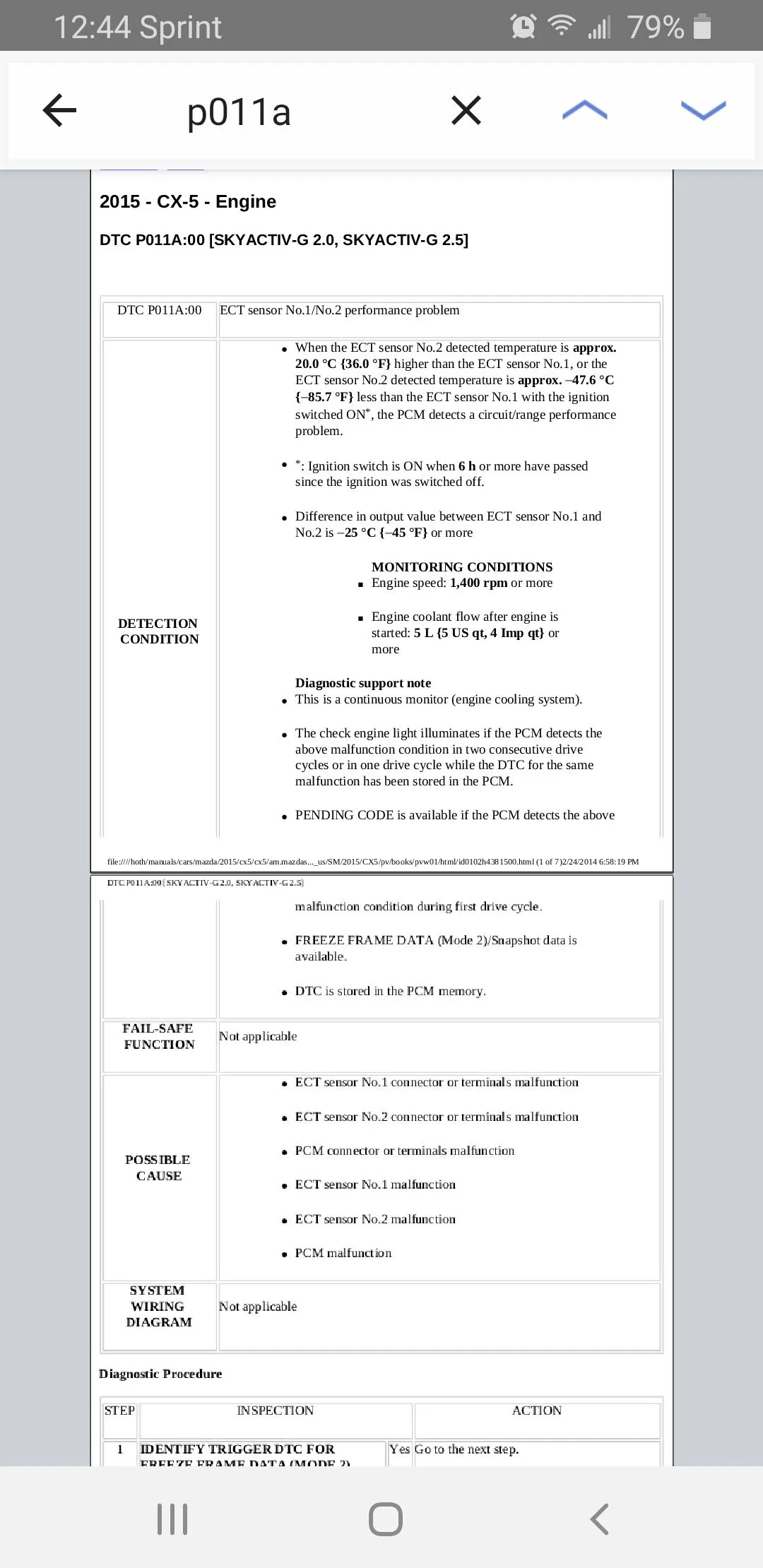

According to WS manual there isn't much to do in fixing the P011a code. In fact the sensor is like 4/5x cheaper than the diag. As far as the heater core idk. Its under the passenger dash
