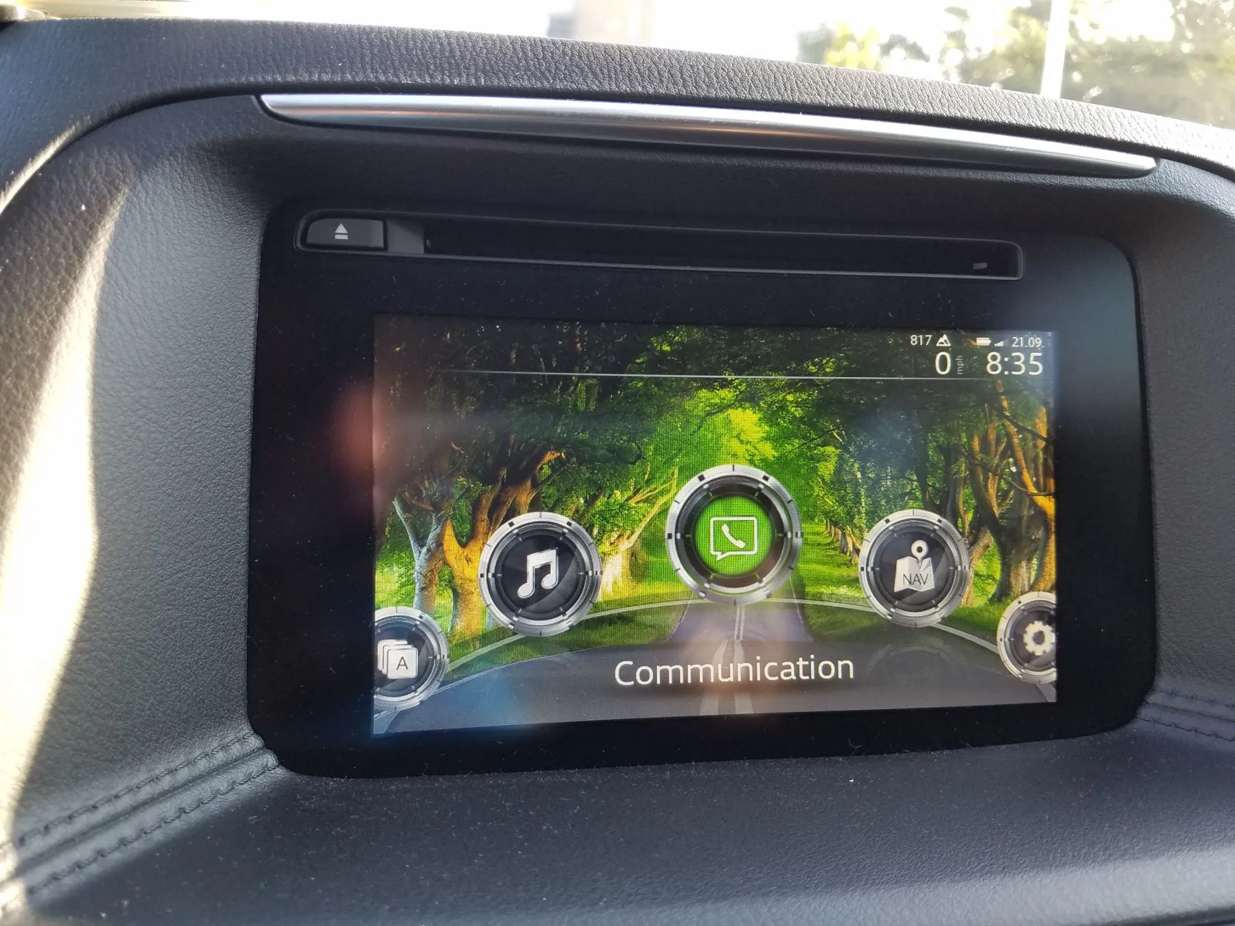

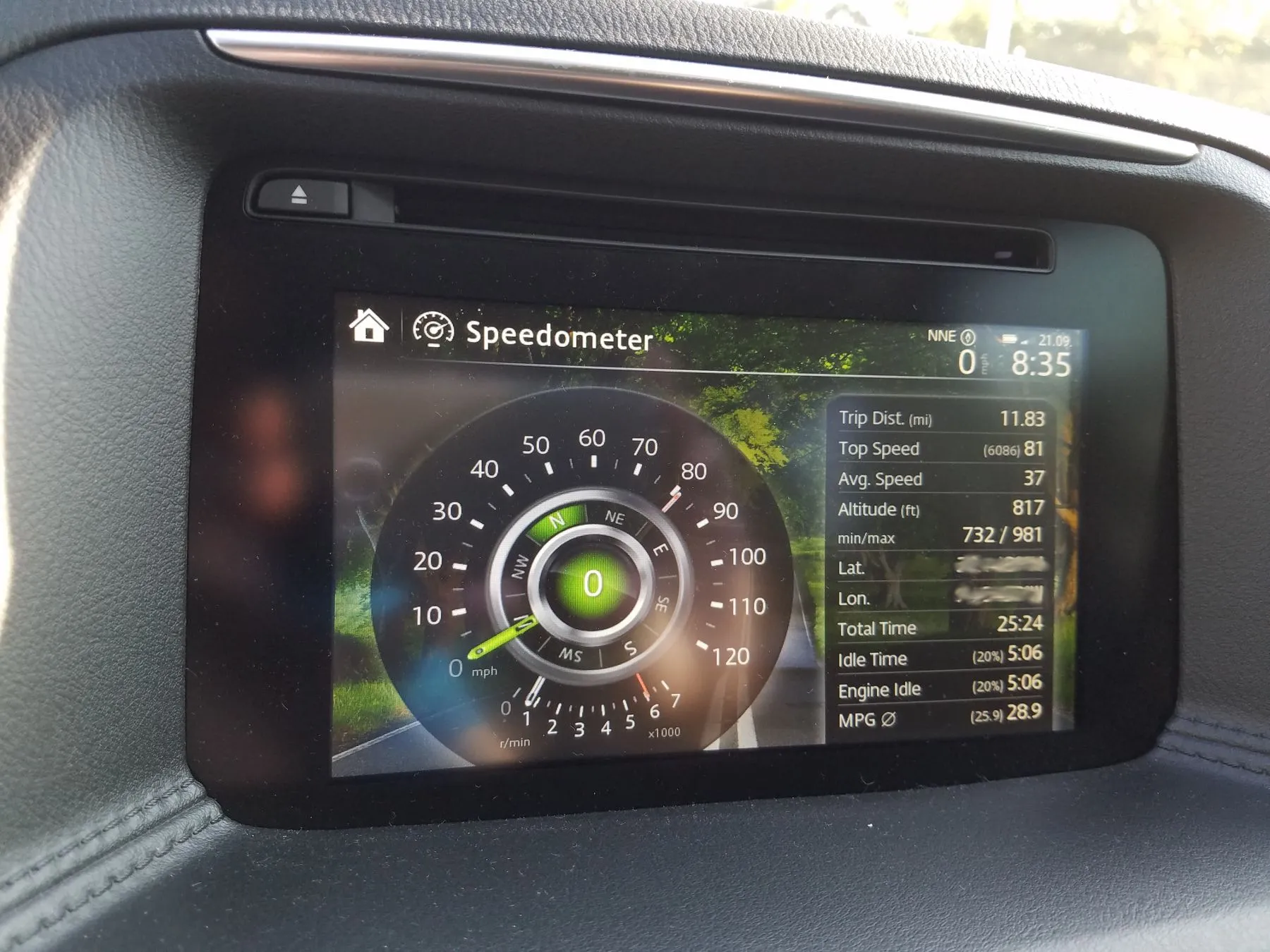

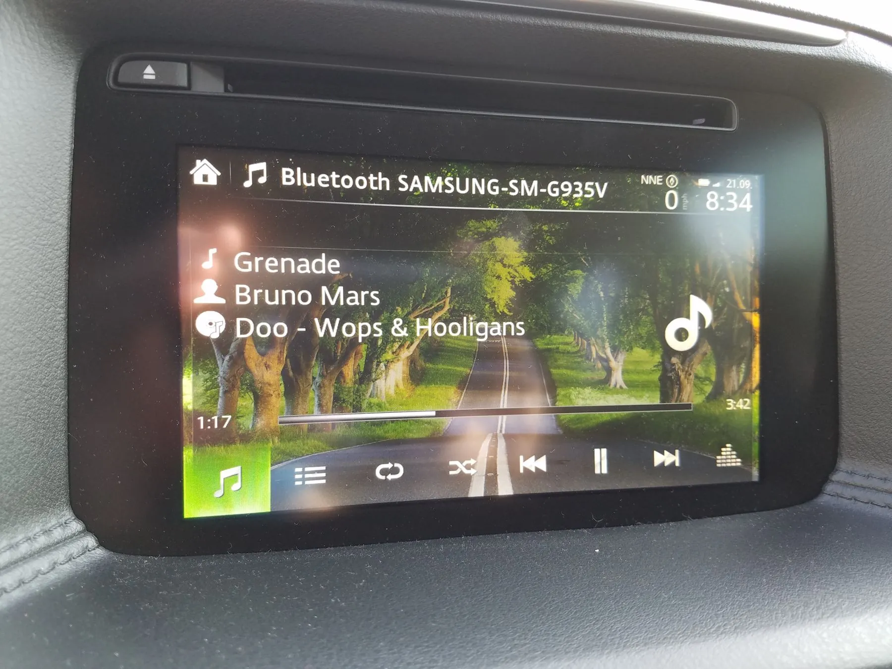

Here's some screenshots of my current setup. I don't have any currently of the CastScreen or Android Auto though. I was meaning to take some tonight or tomorrow morning.
