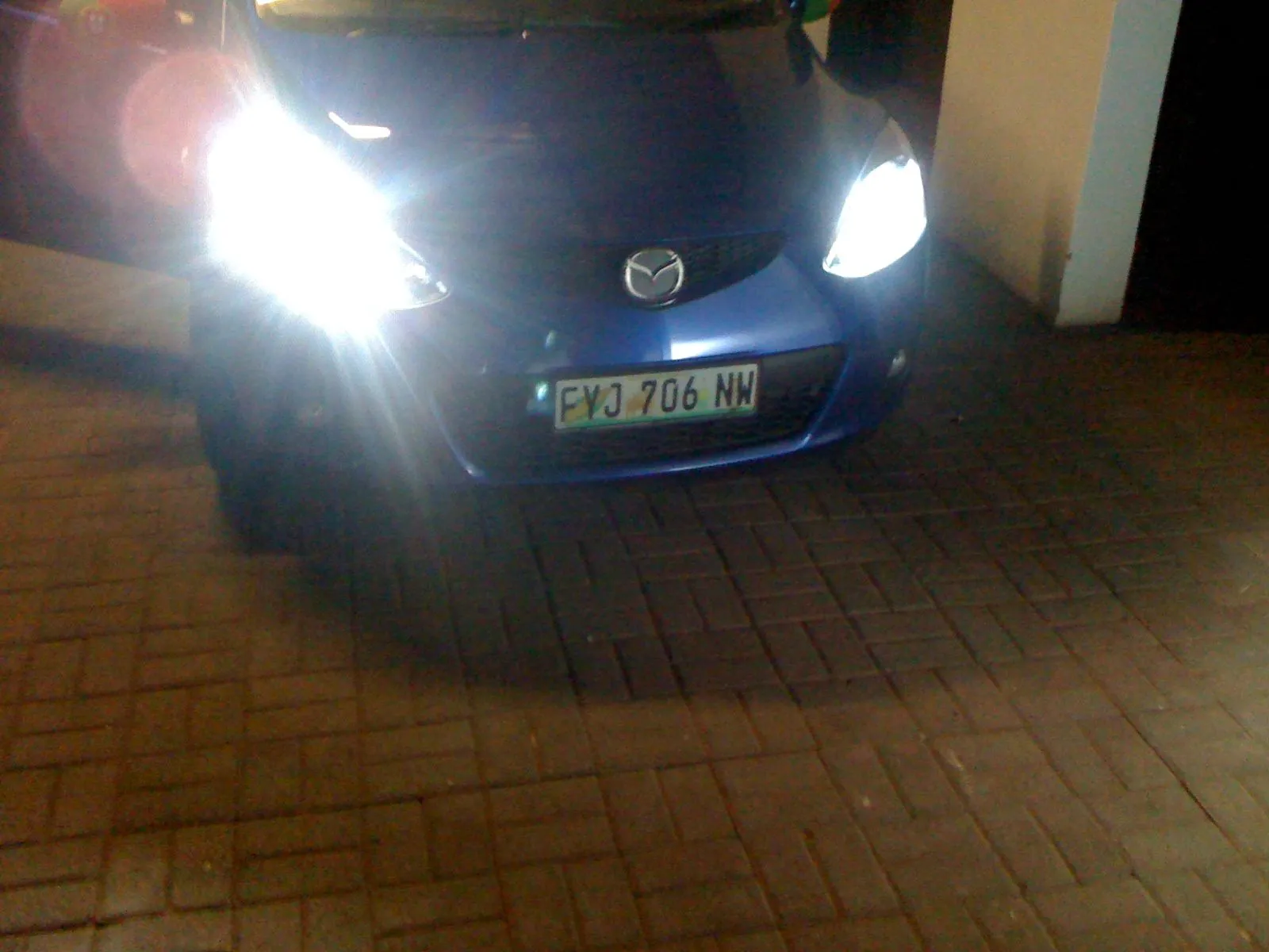

I HAVE HID's
Hey man I have Kensun 10000k's in my 2 for about a year now and about 2% of drivers flash you but it's always people that have no idea what is a Xenon light.
The lights must just be set to their lowest.
Don't take the wheels of, you can easily change bulbs through the bonnet.
Here's a pic!
