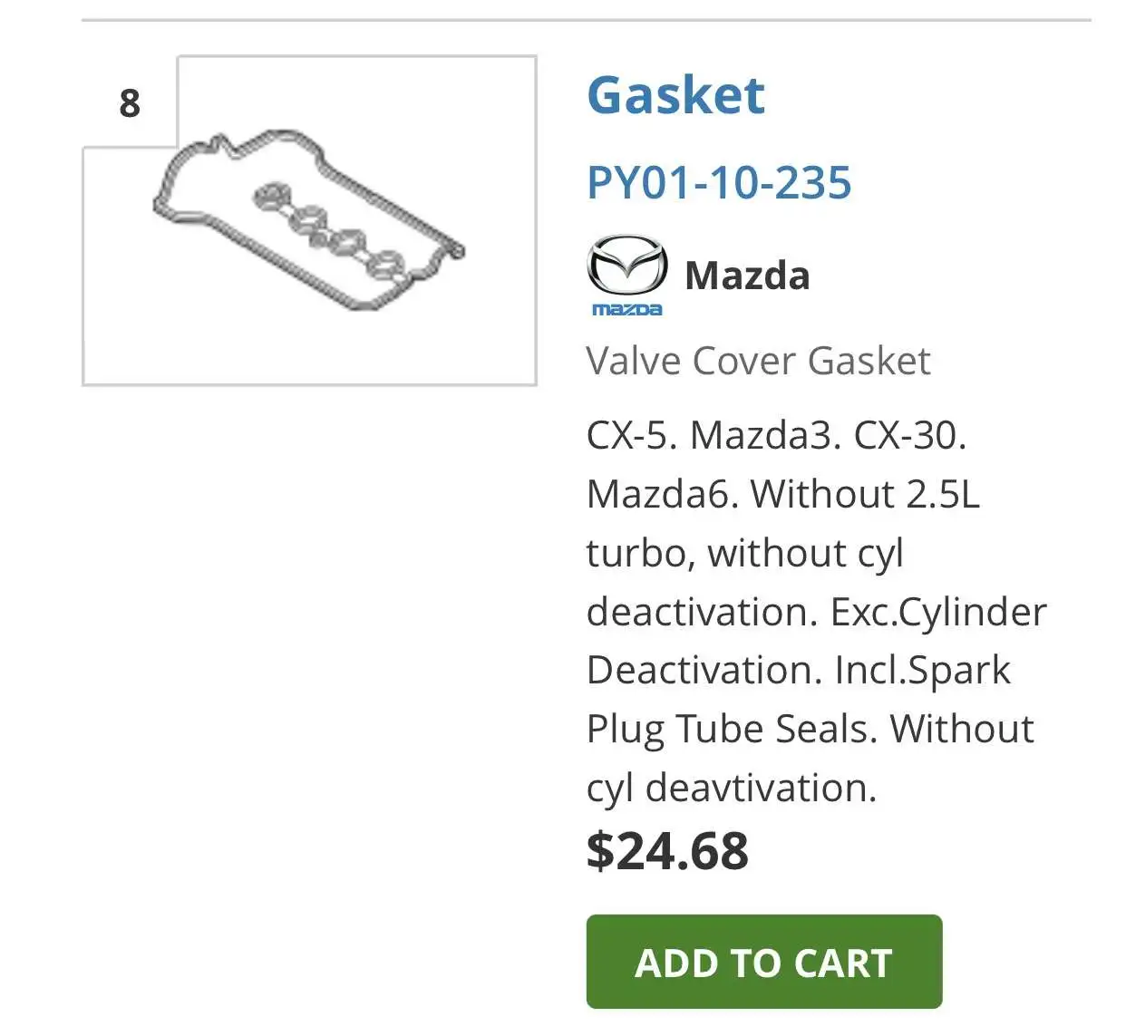

I plan on changing the spark plug tube seals. I'm just wondering if you experts think that will fix the problem. Is this a known problem with this car? BTW, the car has 115,000 miles on it.

If “the top of the plugs” meant the ignition coil pack connector area (external), it’s time to replace the valve cover gasket, not spark plug tube seals. Yes this’s a common problem for any engine with 115,000 miles.
While you’re there, you may want to replace the oil control valve on top of the engine as it most likely is leaking too.
If you plan to DIY for the job, search the forum for good instruction such as this:
Guide Mazda 2.0 & 2.5L Valve Cover & Oil Control Valve Gasket replacement
