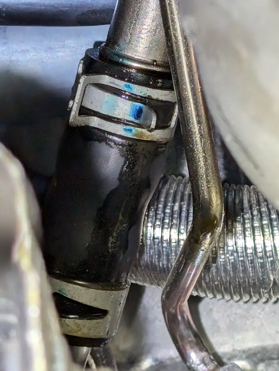

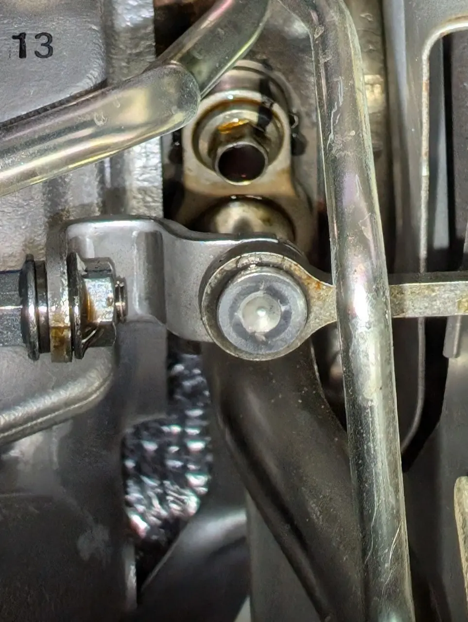

Took the new 24 CE T CX-5 in for second oil change at 7400 miles. Went to a Mazda centric independent shop this time. Tech found oil seepage, driver’s side from underneath. Not sure anyone just changing the oil would have seen it. Taking it back to the dealer as warranty work.
Pics for info taken from behind dust shield while on the rack using a flash light.

Heads up y’all..

Result,
It was a leak at the turbo discharge flange. The line. flange and gasket all replaced under warranty.
Dealership was responsive and had it fixed same day I took it in without an appointment.

Went back to Mazcare for another oil change and they identified the same leak. Went immediately to the dealer and made an appointment to drop it off. Service tech remembered the issue from Dec and mentioned swapping out the turbo on the next visit. I’ll keep ya posted.
As a side note , I can’t find this issue on any forums or postings.
