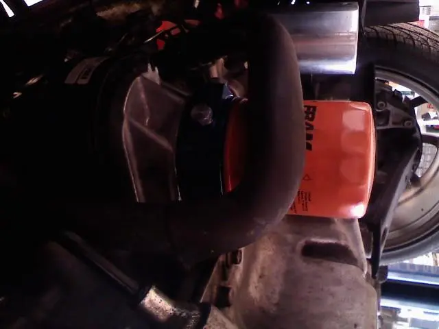

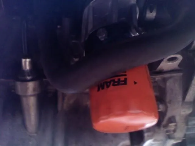

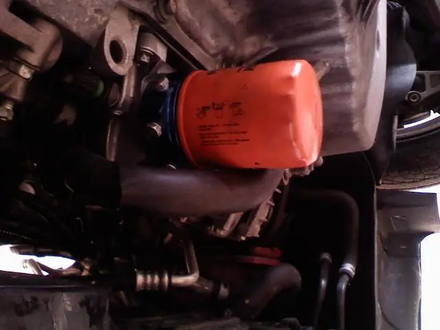

I just did this last week; see how-to. In the end, totally wirth it IMHO. I just took old one off, put new one on its place. I didn't use pipe-thread, just he-manned the four bolts and the top 15mm bolt, and the canister. Used oil on teh seal. No leaks. Easy, easy down the road, esp. with my kwik-valve. Plus you have more "performance" filter options with the spin-on filters, no?
