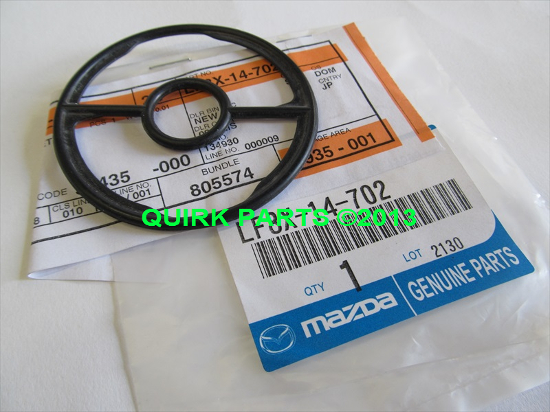

Mine looked more like the Dorman with the black plastic frame and blue silicone seal, also my OEM oil cooler was black and had one 90 degree fitting, i ultimately installed the "Mazda5 Mexico Oil Cooler Model with two straight fittings"

Look at the last(3rd) Picture of the gasket that shows the oil cooler in detail. it show where the OEM All Black gasket, inner flat lip catches and is held by the tab, this might be update version that I'm not aware of when i did my replacement

Vasy's suggested gasket:
http://www.ebay.com/itm/2008-2014-M...2a35c04:g:yr0AAOSwEeFVGZWz&vxp=mtr&rmvSB=true
