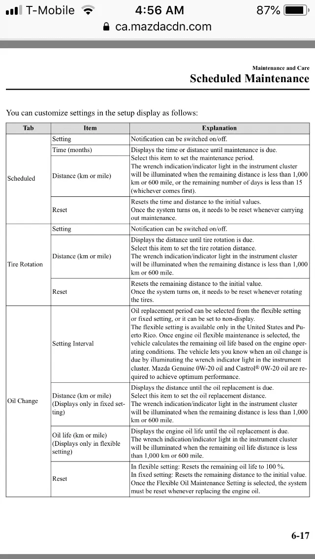

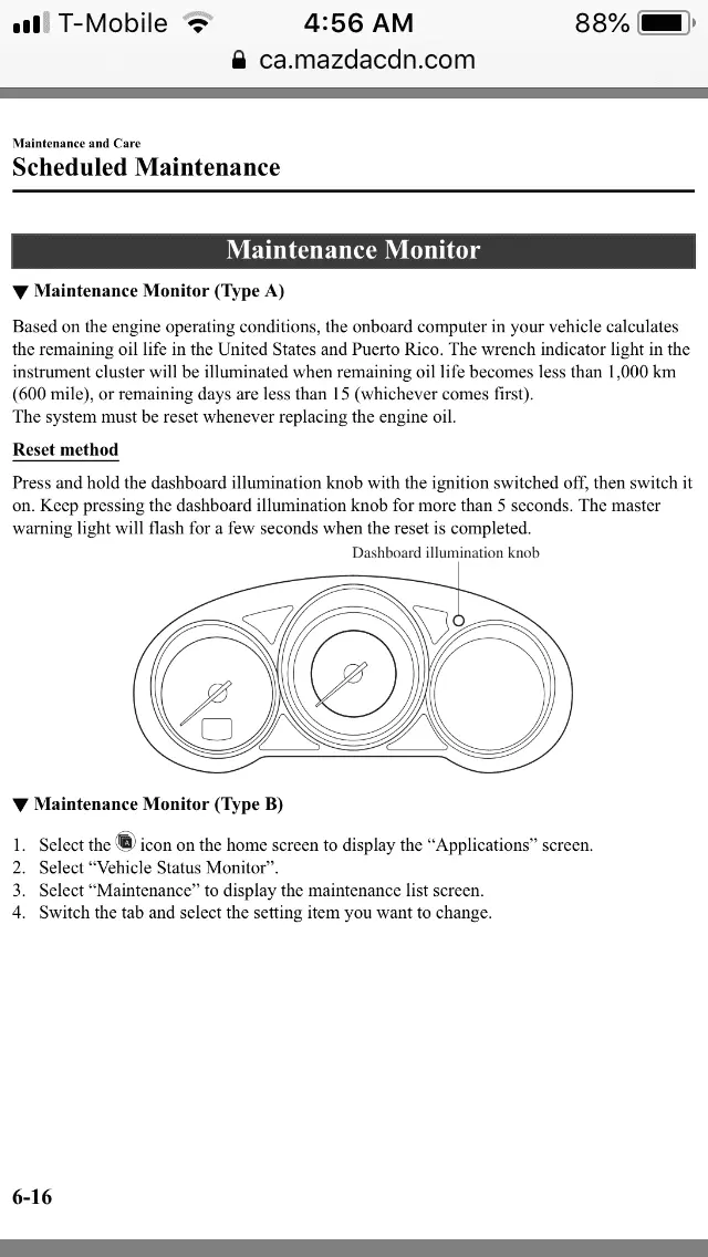

Although the maintenance schedule for Canadian CX-5 does say using fixed 8,000km / 6-month interval, but the Flexible schedule function may still available in Maintenance Monitor. Can you check if your Oil Change in Vehicle Status Monitor doesnt set to Flexible? And did the Fixed schedule under Oil Change, not Scheduled, been reset to 8,000 km / 6 months after the oil change?

I did manage to resolve the issue as descibed in the "Type A" method you posted above, even though this supposedly only apples to the USA and Puerto Rico. After Googling the problem, I came across https://youtu.be/EO0D1-uZq84 describing how to reset the warning using the dimmer button on the instrument cluster. It seems that took care of the problem, at least for now. Very strange that this warning seems to exist, completely seperate from the maintenance app.

If you read the manual, the "Setting Interval" in "Oil Change" says "Oil replacement period can be selected from the flexible setting or fixed setting, or it can be set to non-display." I guess it means you can't actually "disable" it at all. I believe you could also eliminate "Oil change due" message by the "Reset " in "Oil Change" as the app thought it's passed due although you couldn't see the mileage for "Distance" down to 0 km. I'd select "Fixed" instead of "Off" in "Oil Change" at least to try out if it works as intended and no more oil change warning message displayed next time after the reset.
