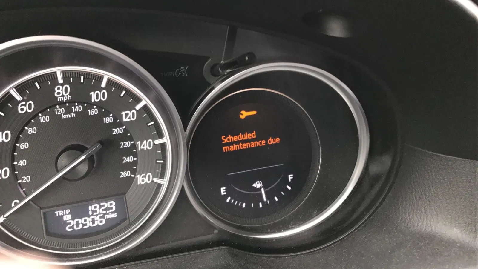

My current working theory is that 'Service Due' in x miles appears for a long time (with escalating notifications, IIRC) just to keep you updated on when your next service/maintenance is due. The wrench and 'Oil change due' come on at 1000 km = 621 mi before due, to emphasize the point and indicate what type of service is (about to be) due. Perhaps something like 'Scheduled maintenance due' and 'Tire rotation due' come up when applicable, if you have those notifications set up.
Well, you said it and I have a picture to prove what you’ve just said ⋯ :)

attachment.php
These 3 items for maintenance I feel “Scheduled” is almost useless but it can be set for any fix mileage or time maintenance items other than oil change.
