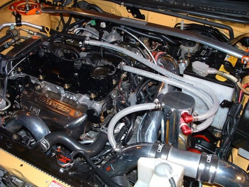

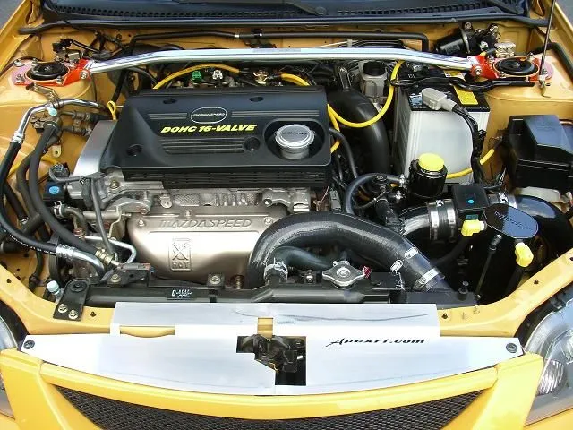

this is a pic of the famous Daedalus' enigine bay...looking at his catch can, is there an advantage or disadvantage in his (chrome) and mine (black)? he had to use sealant to keep his from leaking, on the other hand my catch can hasnt had a DROP of oil since i intalled mine.....
mine goes from the intake to the can and from the can to the valve cover (side location NOT the PCV)
his goes from the intake to the can, from the can to the PCV and the valve cover (side location)
should i re-route my lines?

The way you have it is fine, the catch can is just a way to keep the oil from the turbo the way you have it. You can route it the way he did but there is really no reason to.
its just odd that his catch can was actually overflowing with oil and mine has been bone dry since day one. the amounts of money and mods he has on his car may have something to do with the amount of oil his car uses vs. mine....

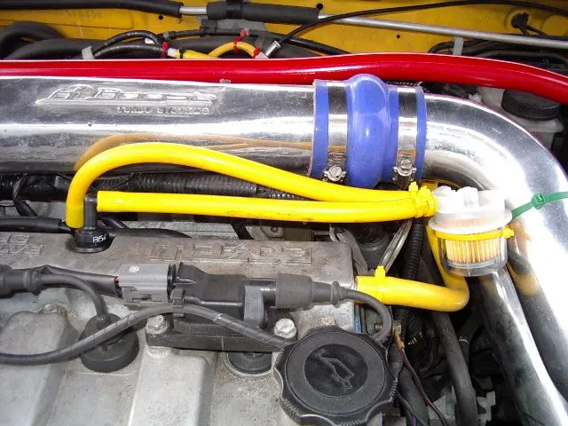

im going to re-route my lines to connect with the pcv (both lines in and out), upgrade my pcv valve and continue to use the intake to valve cover hose. as shown but substitue the filter with a catch can.
Why are you using a fuel filter to catch moisture out of air?
thats not my car (just an example) i will be using a catch can enstead of the fuel filter.

The PCV valve lets oil vapor from the valvetrain to enter the intake manifold, but only during vacuum. What happns withoutthe Millenia PCV, is it lets the valve cover become boosted undernieth it, and can piss oil out into the intake.
You need your catch can in between the PCV and the 2 nipples that go into the intake manifold. Leave a small breather filter on the side of the valve cover.

On the drivers side of your valve cover. Thick vacuum hose. Replace it with a beather filter.

You need the line to come from the PCV, into the can. Then another out of the can, and into the twin nipples on the IM.
