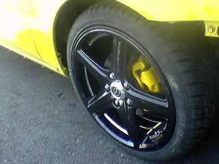

Finally got my wheels mounted with new tires. MSP Racing Harts powdercoated a gloss black with inside ledges left unpowdercoated:
Will get a bigger overall pic when I get front bumper, lip, and new sideskirts back on. (2thumbs)
Cool! The rims look great from what I can see....can't wait to see a better shot so we can see the contrast with the inner ledges.
