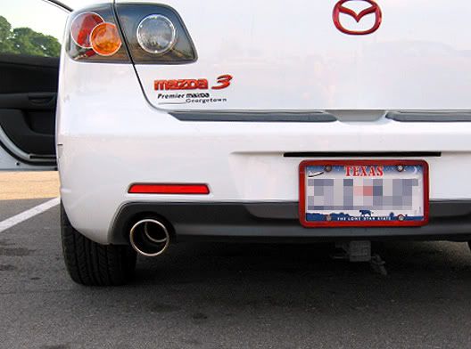

I ended up with the Vibrant through a GB on the other forum and finally installed it this morning in my gravel driveway. I don't recommend that last part, btw. This system comes w/it's own high-flow cat, and is flanged, so it costs a little more.
First impressions: Install took about 1-1/2 hrs due to the usual learning curve (had to undo some of what I had done and redo several things), and Vibrant decided I could reuse the cat bolts that are welded on(?) and did not provide a new cat flange gasket. I had to reuse the old one and so far it seems OK. Even on a gravel drive I might have had the install done within an hour had it not been for these problems. The upper flange bolts are very hard to reach. I had every 14mm wrench and socket I own out there for this.

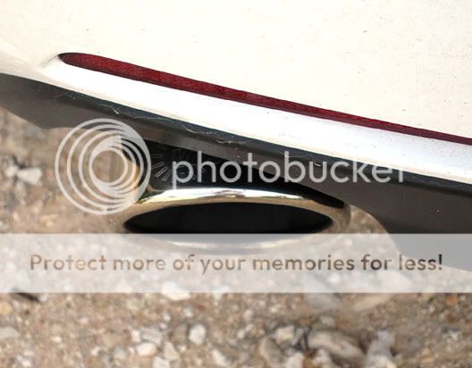

I would rather have the ARK tip. Vibrant's is a single wall, 4" variety vs. their 4" double wall, but it does look good.
The sound though is just what I was looking for. When you're on it, you know it's there. When you're cruising you can't tell that it's not the stock system. No raspiness. No droning, just that low, deep growl, if you know what I mean.
