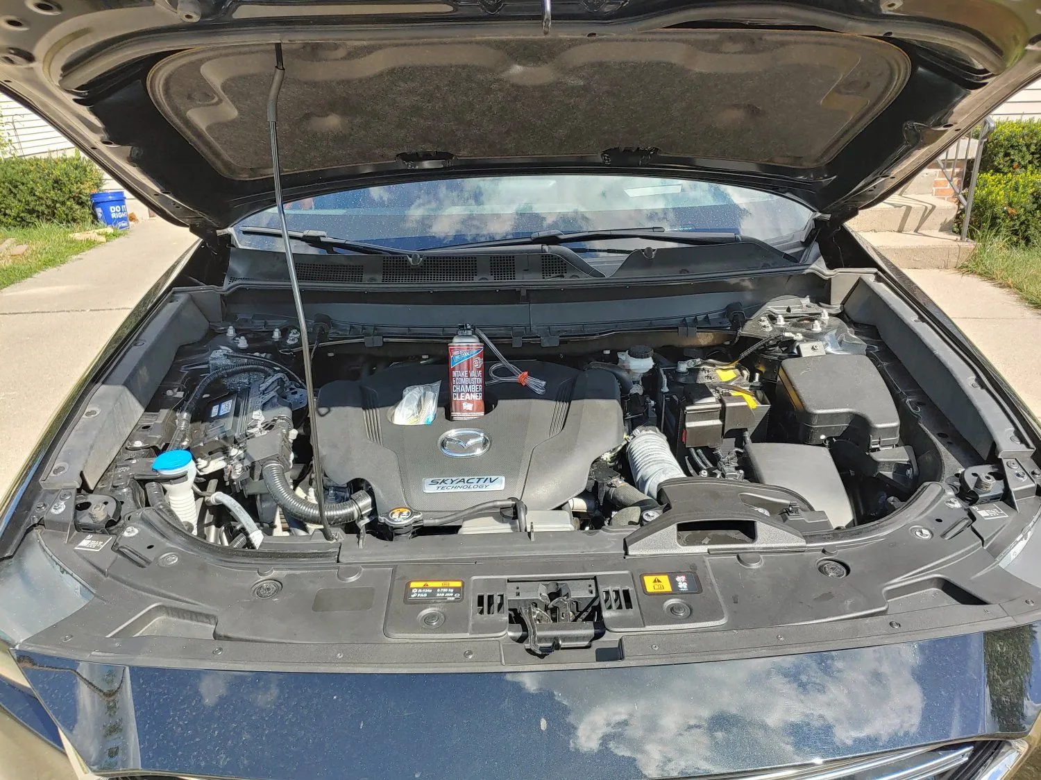

Step 1: Open your hood
Step 2: Remove the engine cover

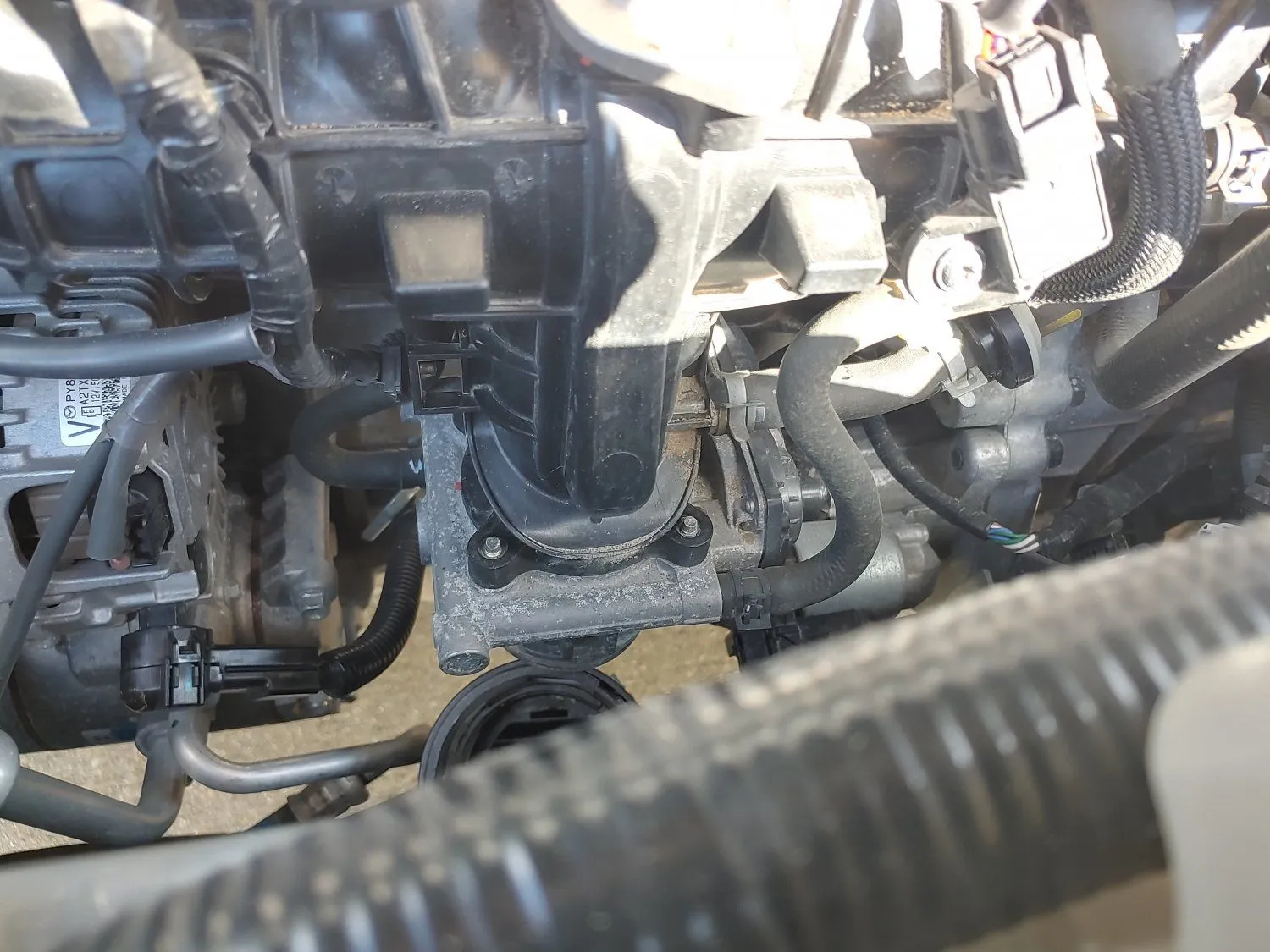

Step 3: Locate the throttle body toward the front of your engine bay see picture below: (Don't mind my intercooler pipe being disconnected I was experimenting with ways to use this kit)

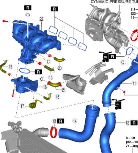

Step 4: Above the throttle body is the plastic intake manifold.
A. The rubber Vacuum hose (#19 on the picture below) right above the throttle body on the lowest part of the intake manifold is the vacuum hose we want to remove. Not hose #16! Which is connected to the metal throttle body housing. That is a liquid filled coolant line! This hose has a metal clip you need to squeeze with a pair of pliers and move it farther down the hose to be able to remove the hose from the manifold.

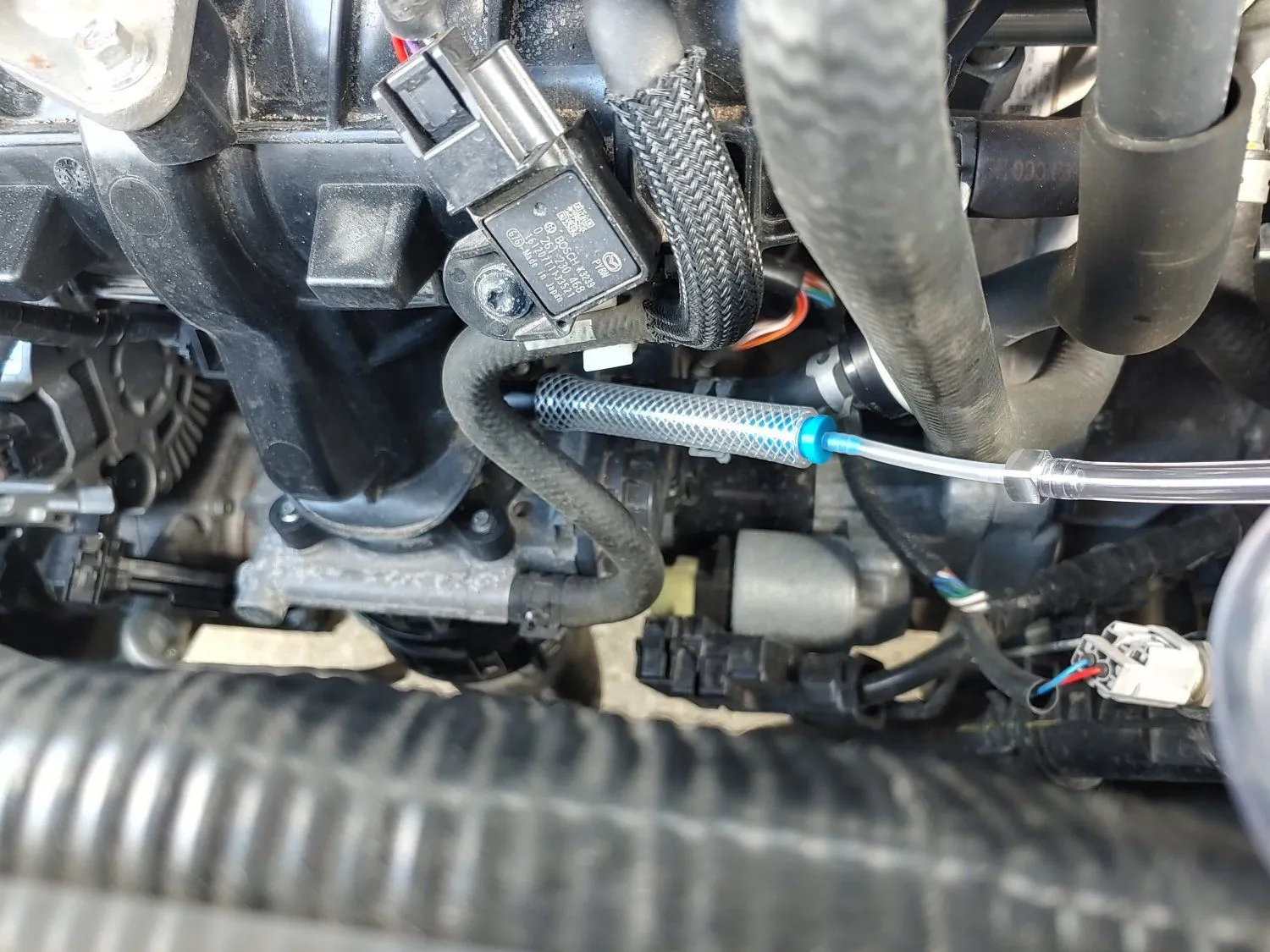

Step 5: Once removed you need the larger of the 2 braided hoses in the kit. Slip this over the plastic nipple on the intake manifold (If you have trouble getting this to fit, you can heat up the hose with hot or boiling water).
Step 6: Use either the 4 or 6 sided reduction fitting from the kit and attach it to the can side of the long clear hose. I had to use the 6 sided fitting because the 4 sided fitting wasn't working, I'm not sure why.)
Step 7: Attach the blue stepped fitting hose side to the output side of the reduction fitting.
Step 8: Attach the blue stepped fitting tightly into the large braided hose already attached to the intake manifold. Everything should look like this below:
At this point everything should be ready to go. Do one look through to make sure everything is snug and there are no kinks in any of the tubing. Also place the can on a rag or wrapped in a rag, my can leaked (details at the end).
Step 9: Start the vehicle and push the button on the can down to start the flow of cleaning agent. You can stop the flow by depressing the small button on the back of the plastic cap.
