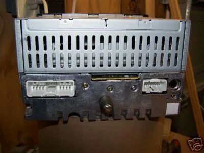

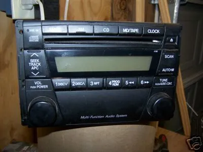

I'm seriously considering buying a used OEM unit from a Protege or Tribute for my 91' Miata (I've attached pix). I really want the 6 disc changer (not in the pix, but same style), clean look, etc and I've heard that they are decent sounding. I've found a unit that supposedly (from the ad) states that it was a premium sound package (from a Tribute) that powered 6 speakers and a sub. Does this sound right?

I have questions about the specs on these units:
  • What's the power rating?
  • Can an external amp be added to it?
  • Anyone know of any of the freq specs on it?
  • Is it true that you can add a sub too?
THANKS!

Compared to a factory stereo in a 1991 anything I'm sure the 200X Mazda dbl-din factory radio will sound much better. However, it is still a factory radio and even $100 aftermarket radios can potentially sound better.
The radio you are looking at has 4 channels, front L+R and rear L+R, just like any other unit. You will have to check the wiring diagrams in the stickies of this section to find out how to wire it up to your 91 miata. You'll probably need a 91 miata wiring harness and a 200X reverse-harness for the radio you want to put in.

You can either use a line-out-converter (since there are no RCA pre-outs) or you can follow the thread in the how-to section on adding your own pre-outs (requires basic soldering skills).
If your plan is to add aftermarket gear, I would stick with the blaupunkt unit (assuming it has pre-outs on the back). The quality will be much better once you have an amp for your speakers.
^^^what he said. although, my understanding is that the stock hu is of fairly good quality, just waayyy underpowered. I think if you got an amp and just used the speaker level inputs on the amp, you'd have a pretty good sounding (yet stock looking) system, not to mention a 6disc changer. I used my stock hu for quite a while, and while I'm much happier with my new hu, the stocker didn't sound bad for what it was. I also used the loc that chuyler mentioned for my subwoofer amp inputs, which also worked quite well, but i ended up just disconnecting my rear speakers and only running my two fronts + sub.

the 01-03 protege ES/P5 radio is better than the protege DX/LX/tribute radio shown above... but the thing is, it has amber illumination
harness connectors are not compatible between the pre 01 mazdas and 01+ mazdas... rewiring will be needed
