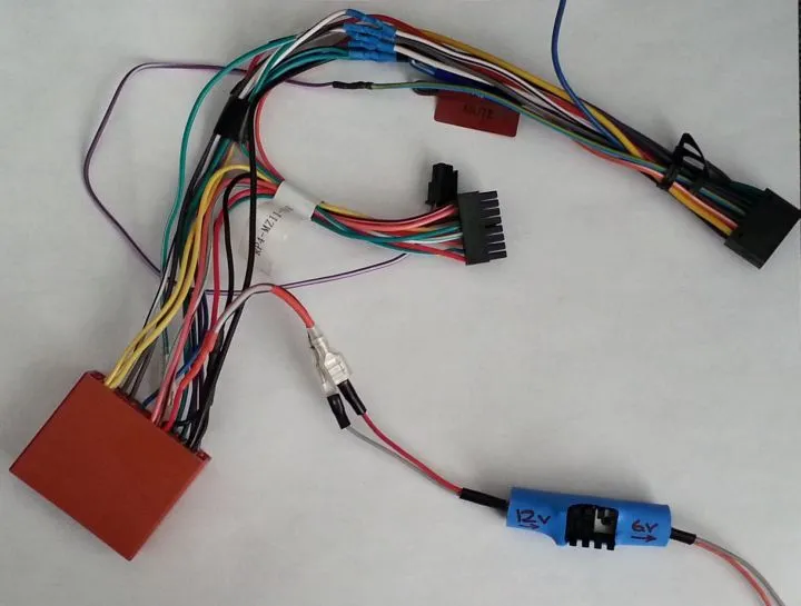

I'm in process of doing this right now. Hopefully done by this weekend and I will write it up afterward. I will be reusing the USB/Aux under the armrest (home made adapter), and the rear-view camera (similar to NCMazda6). Plus, I'll see what I can do about the microphone - though that may come down to just reusing the wiring for the radio's mic, not the mic board itself in the headliner.
For the camera supply, I built my own converter based on an LM7806 regulator and a couple of capacitors, but you can buy a cheap LM317 linear variable regulator board on ebay and adjust it to 6V (like this: click me). I would not recommend getting the switching regulators that are also available, since they can give off a lot of electrical noise and interfere with the video and/or audio signals (e.g. DON't get me).
Teaser... the PAC rp4-mz11 harness (left) wired into my Kenwood DDX491 radio harness (right) and the camera voltage converter (bottom):

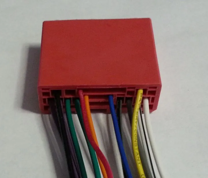

As I was discussing in that other thread, I was tossing up the extra cost vs. having to supply a reversing signal wire. Since I found the RP4 for just $45 more (on eBay) than the cheaper SWC box types, I figured the $45 was worth it for the saving in time and frustration running a wire from the reversing lights back up to the front of the car. Also, the RP4 derives the backlight/dim wire from the CANbus for you. If you use the cheaper SWC box, you'll have to run another hardwire to a backlight bulb circuit somewhere.
One other thing I found too... the wiring harnesses you can get, e.g. Metra 70-7903, to use with the cheaper SWC boxes do NOT have all the pins needed for the SWC wires! You need three (audio buttons, phone buttons and common) but the Metra harness only has two of those (audio and common).
In the end it was simply easier to use the RP4-MZ11, the extra cost was more than offset by the time and effort saved. Plus I now have the '2 functions/button' feature.

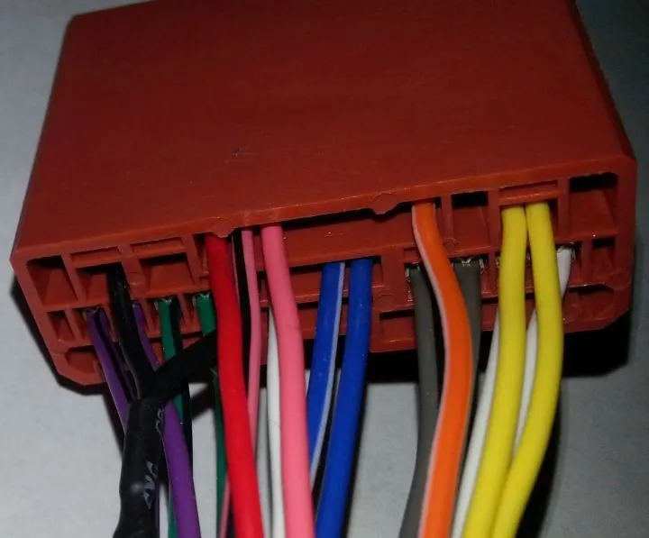

For your reference, this is the Metra 70-7903 adapter harness, showing what wires are populated (or not):
attachment.php
Compared to the RP4-MZ11's harness plug:
attachment.php
