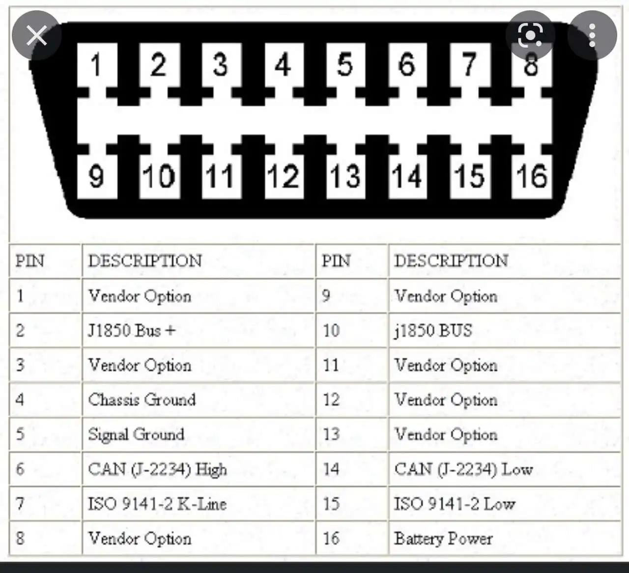

check voltage with a multimeter - on battery and ground first.
4 and 5 are grounds....16 is 12v
Should be constant even if vehicle is off.
If nothing the you have to retrace where it gets the power from. Most likely there should be a fuse connection somewhere.

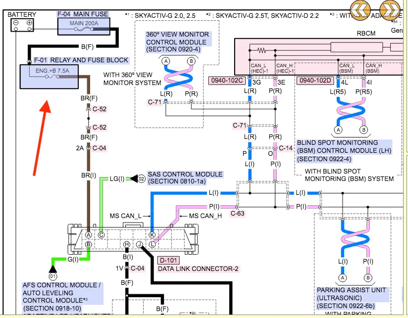

Hey guys, new to the forums and CX5s in general and I'm trying to understand this diagram, if I'm not wrong the blown fuse is the one on the bottom left labeled "A" with a brown line?
Look for that 7.5A fuse in the engine compartment it has the same name mentioned Engine+B on my 2017 3 hatch.
