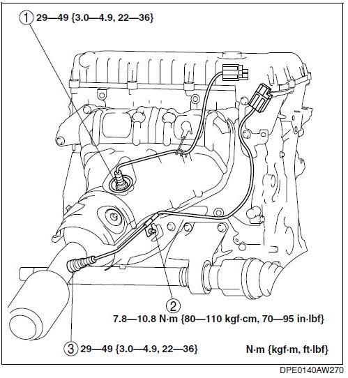

Here's a copy of what's in the 2006 Repair Manual..... I believe the Mazda 5 only has the two O2 Sensor's;

I just had the P0138 code pop up earlier this month. I replaced the downstream oxygen sensor, i.e. the heated oxygen sensor, which is NTK24447 from Amazon. It was around $50 for this OEM part.
From the top of the engine compartment, I disconnected the electrical connector, the plastic tie down (which I simply broke off, the new sensor came with a new one), and unscrewed the nut holding the mid-pt of the wire (10mm ratchet required here). From underneath the car I managed to use a 22mm open ended wrench to disconnect the sensor from the exhaust. I did spray every threaded connection with PB blaster the day before, but the sensor came out surprisingly easily.
After driving the car with the new sensor (which comes with antiseize on the threads already) all day for about 30 miles, the CEL went out by itself.
