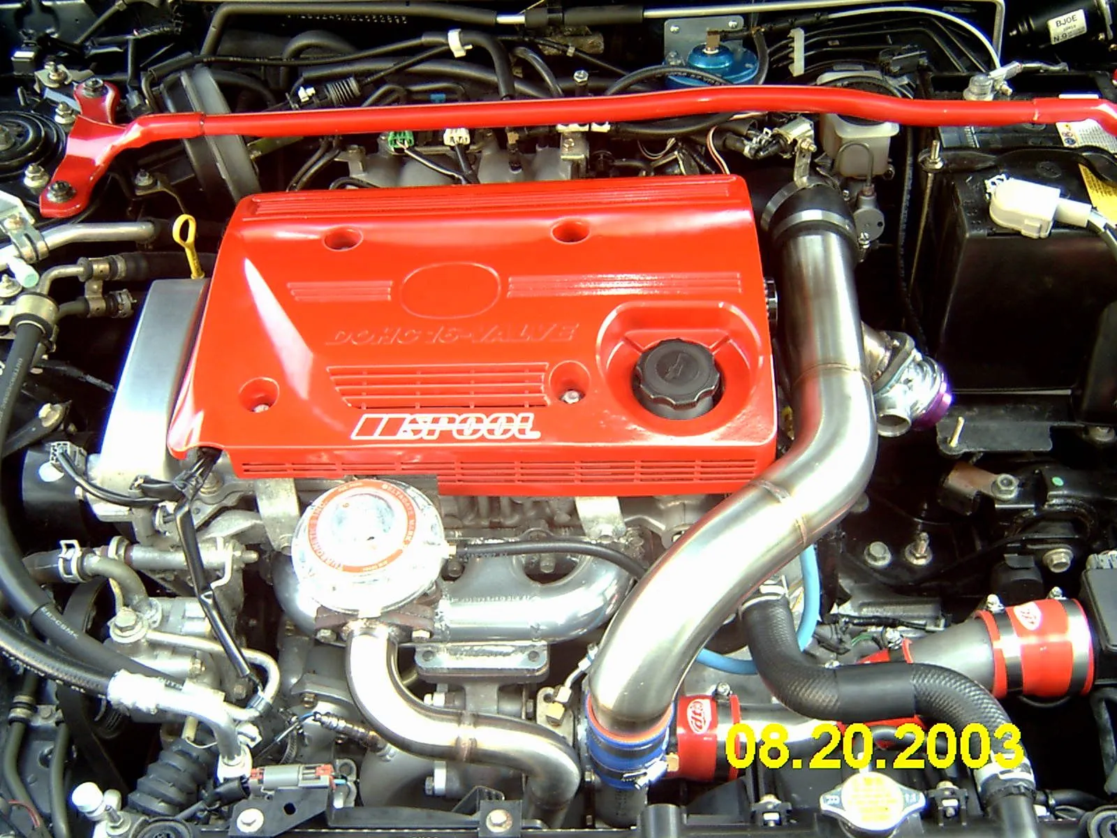

Which is the correct way to wire the O2 unit cause Terry said he had the revised copy and it said that the yellow wire goes to the ECU and the blue to the O2 sensor. I have it hooked up this way and the car is idleing lean. I have autometer A/F gauge I know that this isn't best gauge but for now it would have do til I get a good one .I'm trying to get all the bugs out so I can get all the good gauges.

he told me the same i too was running lean not at idle but under boost i have the tube mani and intercooler so im running around 5psi it was running really lean i reversed the yellow wire and blue wire so that the yellow went to the o2 sensor and the blue was the ecu and my guage is tied in with the yellow going to the o2 sensor is that how your guage is comming off the o2 sensor if not put it there. if so just reverse the wires and let us know how it works.
Hey svxin I reverse the wire and rerouted my guage ,My blue wire went to the O2 senser and the yellow went to the ECU and my gauge went to the pink/blue at the O2 sensor so I switch the but I found it was running more lean than ever and the car was stumbleing more so I switch it back.
