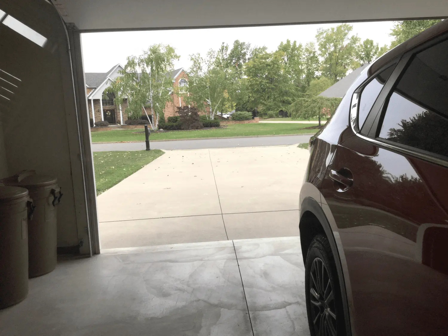

After testing it in a door jamb I applied Nu Finish to the Soul Red paint on my 2020 with 5k miles, along with any other shiny parts. That's the garage door opener and the ceiling bulbs reflected in the hood along with the wipers.
I also applied Nu Finish to the outside and inside of the windows, the inside being a personal hack I discovered. The following picture is shot through the window of the open front passenger door after applying Nu Finish. If swirls on the inside of glass are driving you nuts, after you try glass cleaners that don't work or the Mr. Clean Magic Eraser hack, or the other hacks that don't really work, try this. A few seconds to wipe on, a few seconds to wipe off.
That's about half a bottle of Nu Finish for the whole detail job, $4 US worth at Walmart. I wouldn't use it on any grainy plastic. It's fine on smooth plastic or faux chrome.
For exterior grainy plastics, like the black trim that encircles the bottom of the vehicle, and for wiping down the entire interior I used Meguiar's Natural Shine Protectorant, $5 US for a 16oz. bottle at Walmart. Cleans with a bit of shine, non-oily, says it has Scotchguard in it. I don't see any reason to use anything else. It even worked fine on the faux suede. I think this is my 4th. detail with that bottle with some still left so cost per vehicle is about $1. Spray on a microfiber until damp, wipe, done.
Add some loose change for the wash soap. The wash mit, cloths and sponge are none the worse for wear after going through the washer and will live to fight another day. Total cost for this DIY full detail is under $6 with about 4 hours spent at a fairly leisurely pace.

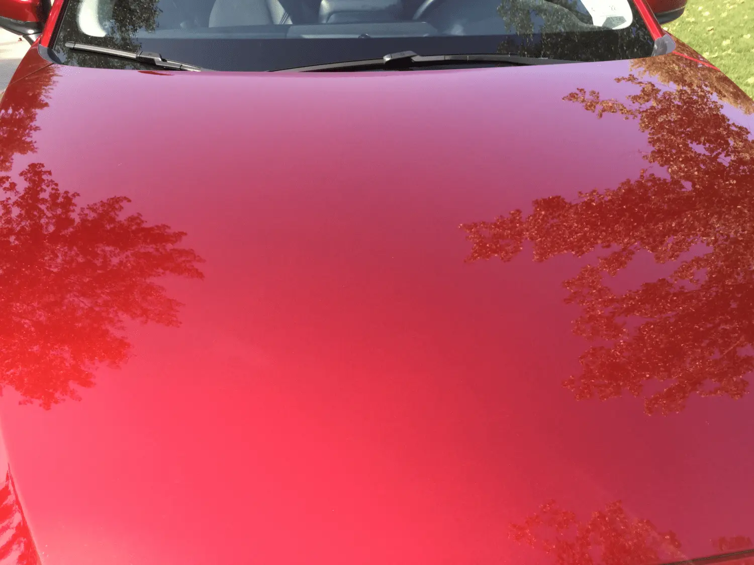

The OP's photos don't really show much. Post a photo of the reflection of bright sunlight on the panel, please.

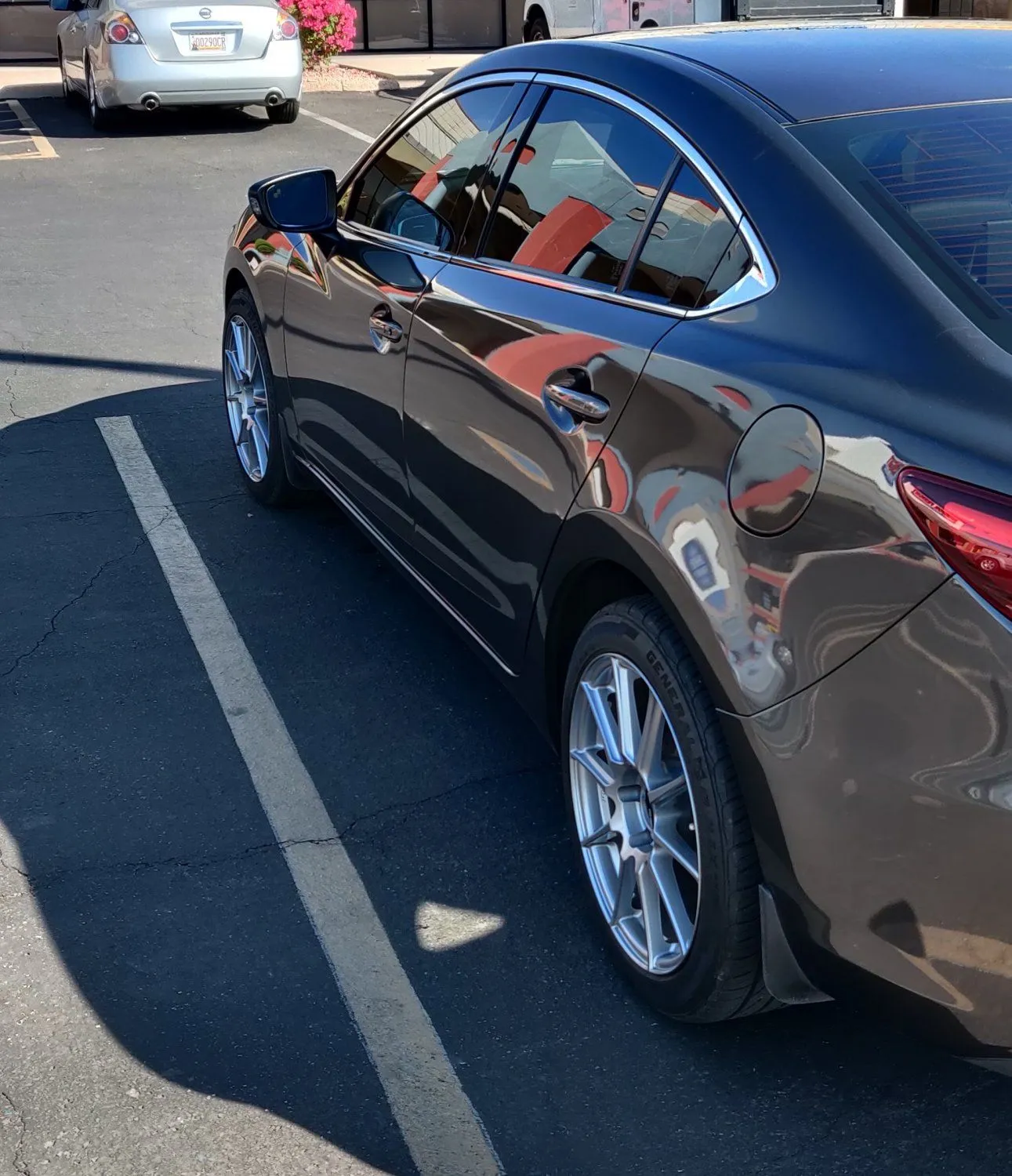

Back to the road tar on the bottom of cars here's an extreme case....then again this is much I'd get in 1 year during my commute if left unchecked.
I thought 6 months was a pretty short time between clay bar treatments too. Have you tried Turtle Wax Bug and Tar Remover? Before I started down the rabbit hole of detailing, I paid a friend to "detail" my car. All he did was spray the areas you mentioned with the Bug and Tar Remover, then buff it off with a microfiber before getting his polisher and doing one pass with a liquid wax. For stuff like bugs and tar, the TW stuff works well, and its a lot less likely to mar the paint. Just a suggestion.

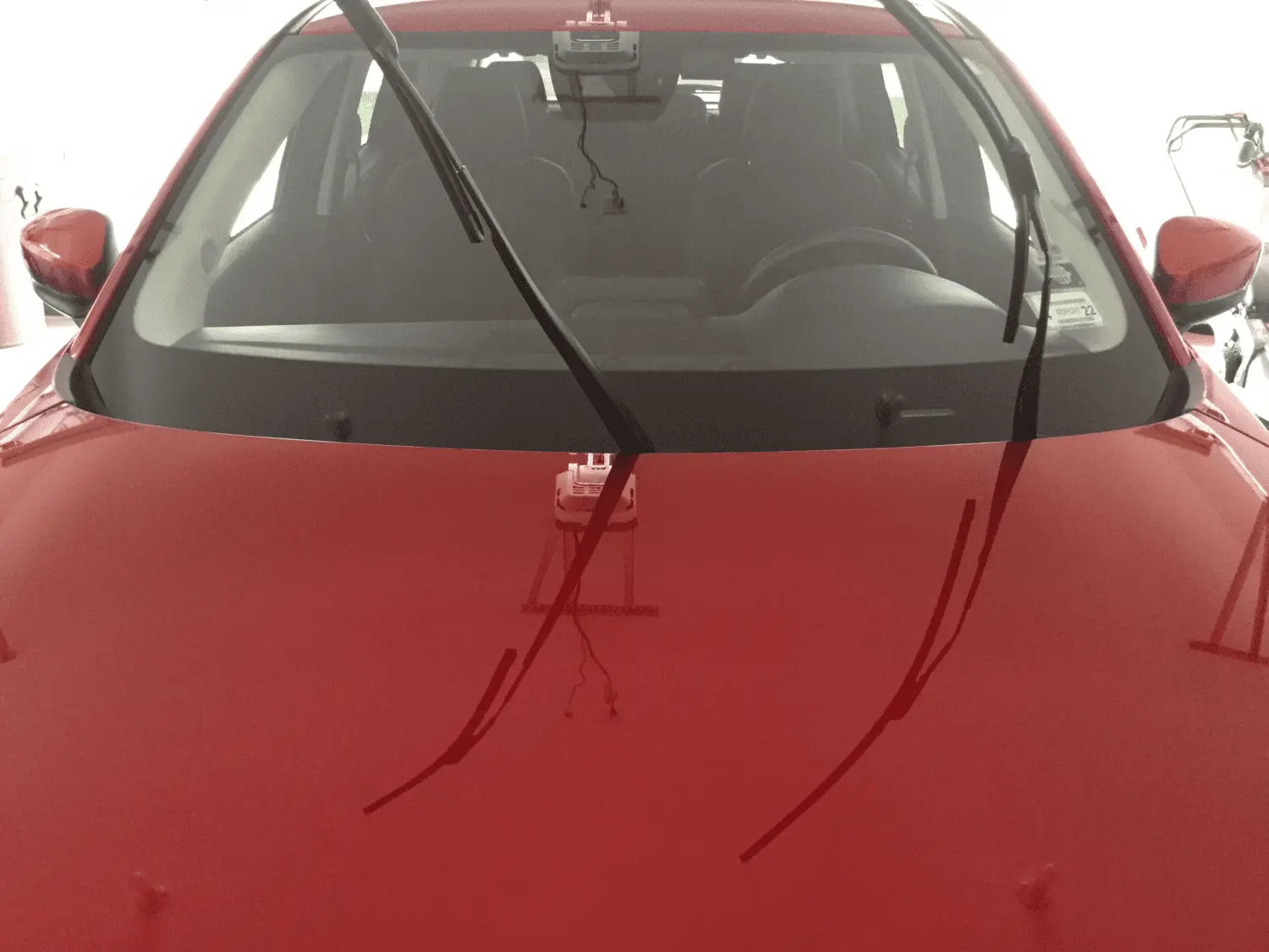

View attachment 227408I also applied Nu Finish to the outside and inside of the windows, the inside being a personal hack I discovered. The following picture is shot through the window of the open front passenger door after applying Nu Finish. If swirls on the inside of glass are driving you nuts, after you try glass cleaners that don't work or the Mr. Clean Magic Eraser hack, or the other hacks that don't really work, try this. A few seconds to wipe on, a few seconds to wipe off.

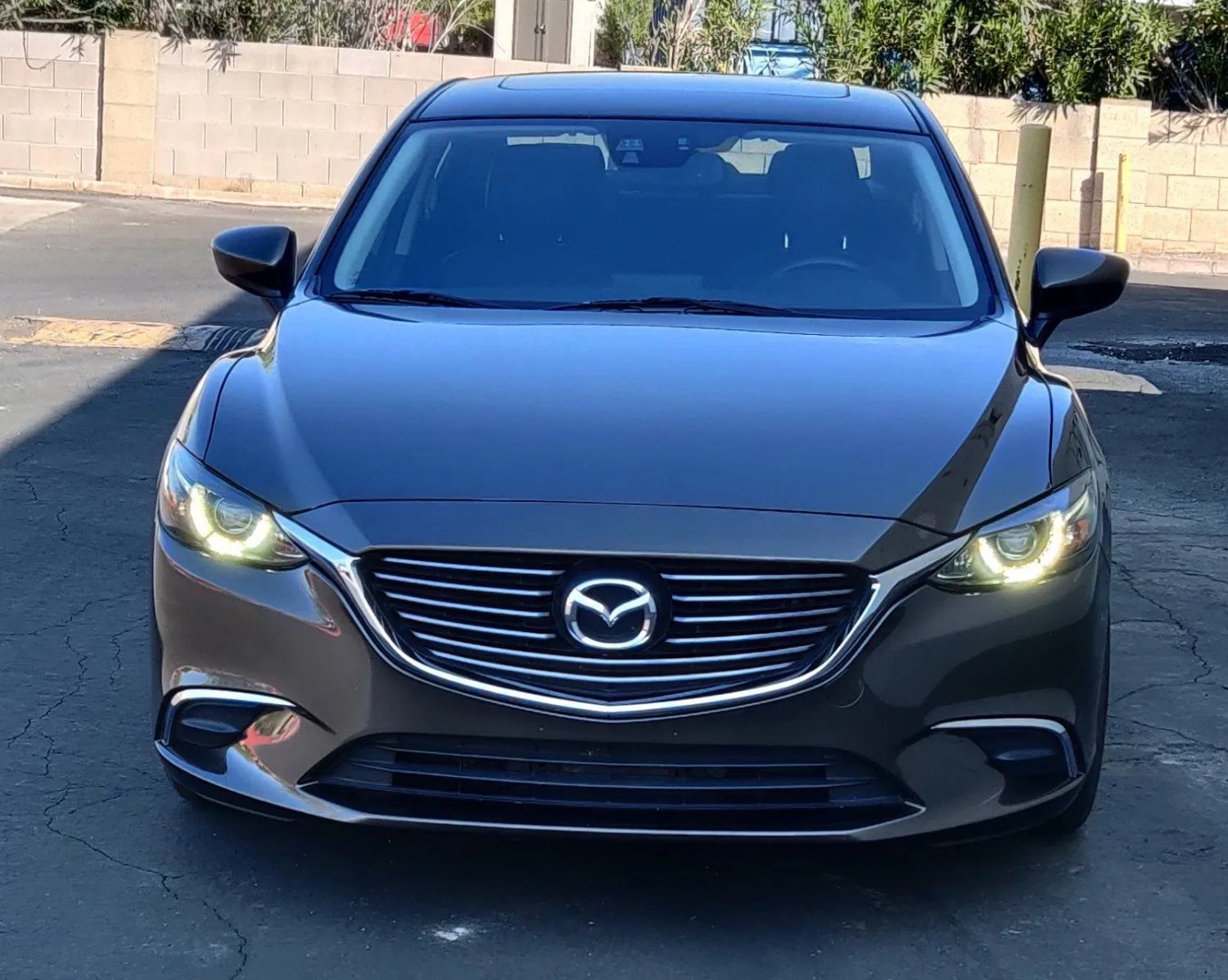

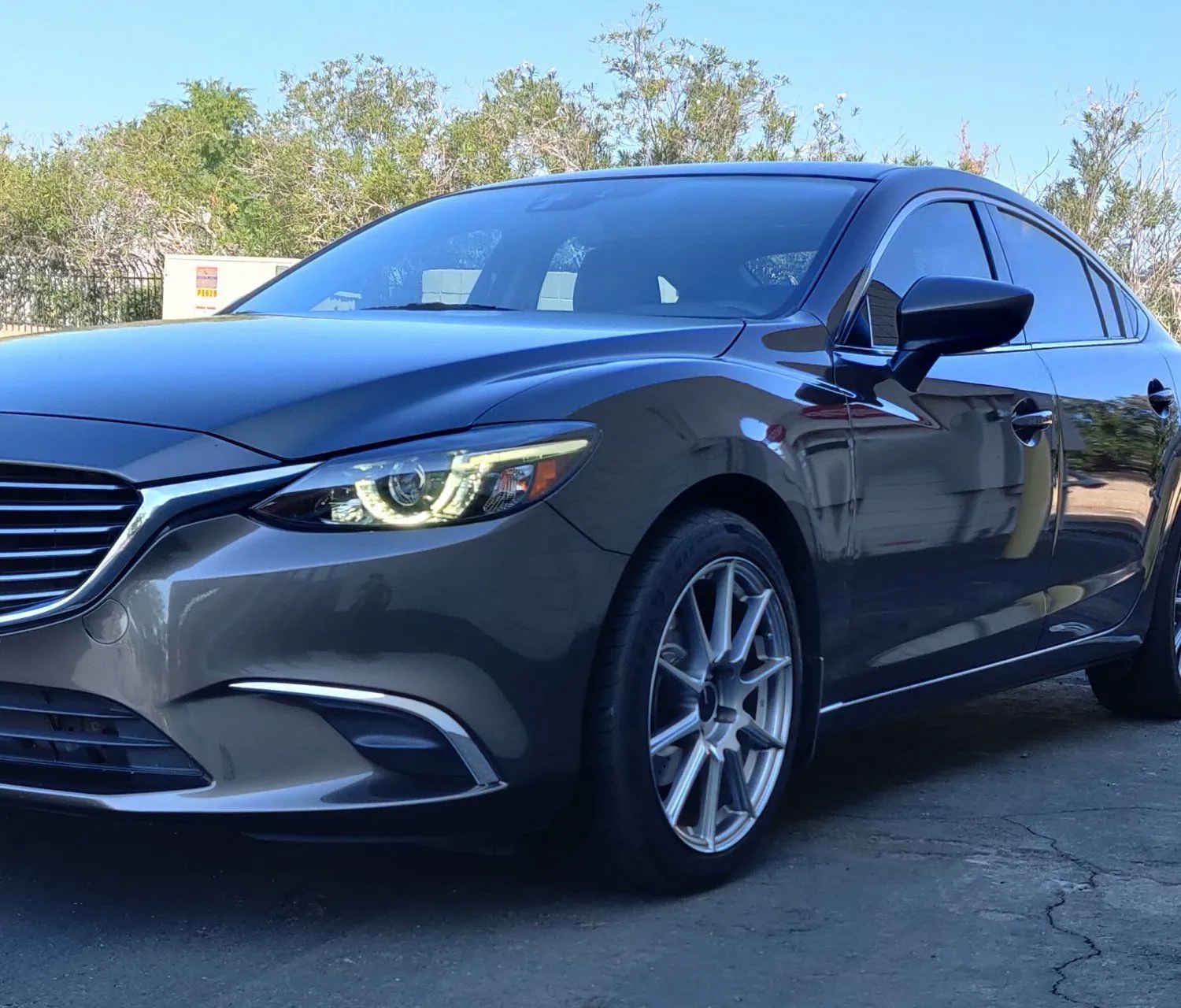

1 product: Optimum No Rinse Wash and Wax.
I spend maybe 15 mins to clay bar Mazda6 ONLY on bottom of fenders, front door and rocker panels every 6 month. Its lower to ground than CX-5. Oh I see why you guys are questioning.....I can't remember last time clay barring CX-5. The CX-5 has more protection from road tar due to mud flaps. The Mazda6 in my commute is not so lucky. Nonetheless 15 mins of my time every 6 months. Not a whole car treatment. No reason to do so. I haven't applied sealant nor my Collinite 845 Mazda6 or CX-5 for maybe 1 1/2 - 2 years now. See pic of my 5 year old Mazda6 with 75k miles from this morning. Monthly treatment constantly builds up protection on surfaces. I get this level of shine and smooth finish using just 30 mins of my time per month to clean all paint, trim, mirror, and windows. My cousin uses the stuff for his interior but I prefer 303 Protectant for that......I may experiment with it though inside.
I got this idea of bypassing traditional wax/sealants from pros I believe from the Autopia or autogeek forums a few years ago.
I previously used product as a detailer every 2 weeks but got lazy. So every month it is.
Wheels: Aside from paint, trim, and windows they are wiped down taking 5 minutes each using moist baby wipes and Optimum no Rinse Wash and Wax. I actually don't wipe them down as often....maybe every 2-3 months or so. When taken off for a tire rotation I clean whole wheel (inside barrel) and behind spokes using Meguiars Ultimate Wash and Wax.
Edit: added 2 more pics. "3M Pro Series" Paint protection film professionally installed on my lower front bumper. to save money I installed it on my hood (18 inches up) and on headlights myself.

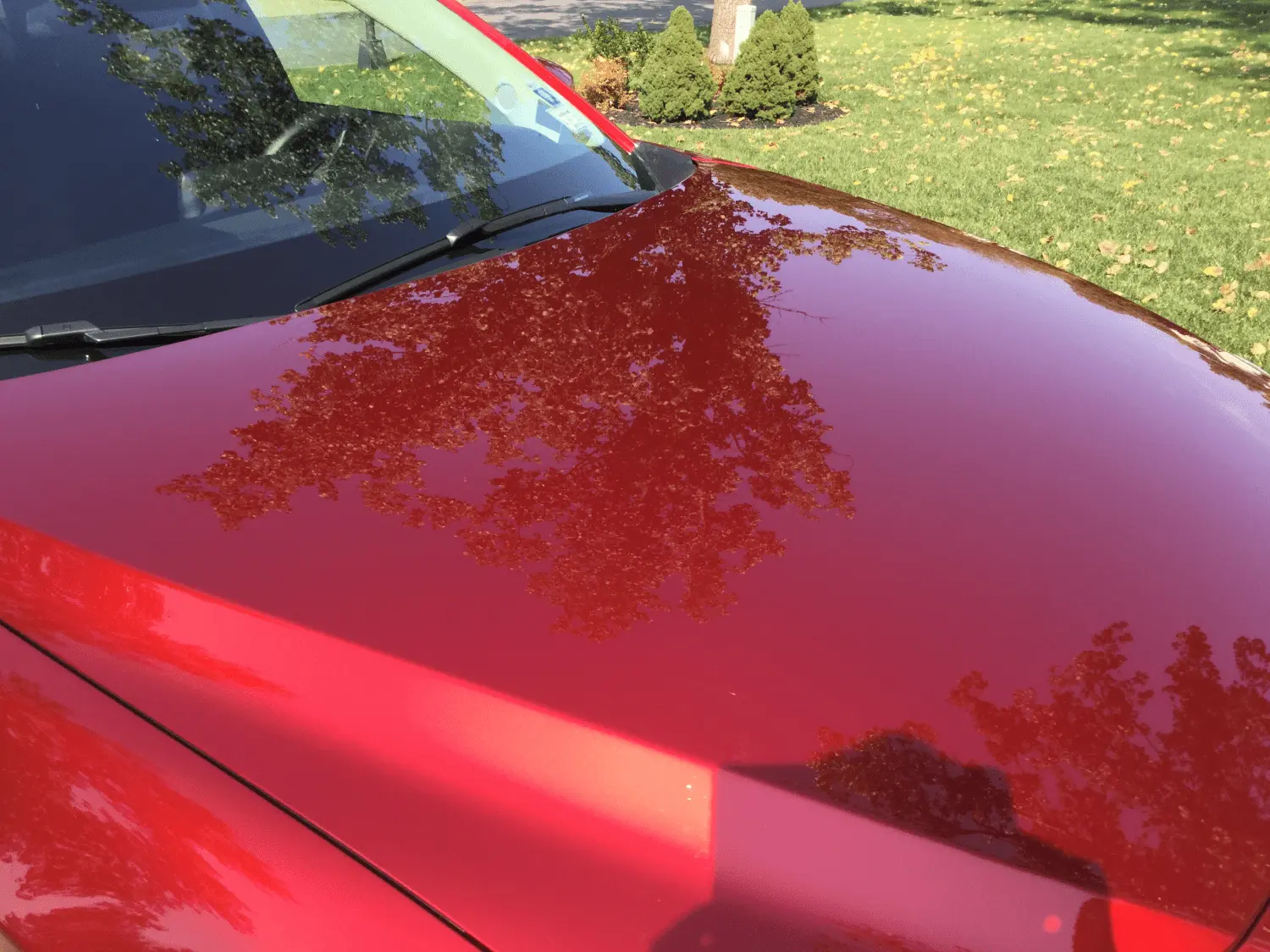

Sunshine photos below. Again, this is a one year old vehicle, 5,000 miles. As discussed in another thread, the left side of the hood was treated with Adam's Iron Remover after the OP pictures were taken with Nu Finish reapplied. Otherwise, it was just washed followed by a Nu Finish application. I've not gotten around to doing the full hood and roof with Adam's yet. The sides are quite smooth and don't require treatment.
The car's a little dirty in these photos, not washed since the OP, but I gave the hood a light rub down with a microfiber for the pictures. You'll see some swirl marks around the reflection of Ol' Sol which might be from when the dealer purportedly detailed it in June or I might have caused it. They look oddly chunky in this photo but are actually quite fine and can't be seen from a few feet away. A couple of the white spots are dings; others like on the left edge of the hood I have no clue because I could not see them with the naked eye when I went back to check it out, maybe road splash I subsequently wiped off.
As others have said, it depends what you're going for. I think the depth and shine is quite good and it should be well protected through the winter. For show car appearance, other steps and products would no doubt be required such as a finish restorer to get out the swirls. I might or might not get around to that someday.
My experience bears out reports from others that this vehicle has a soft finish. There are more blips on the hood and roof paint where the Adam's has not yet been applied (industrial fallout I'm thinking) than on my recently departed 2006 Accord which was quite smooth with no deep cleaing or restorations since a clay bar job about 10 years ago. The CX-5 is about on par blip-wise with the roof of my 2014 Sienna with 90k miles which I had not noticed before becoming blip obsessed. I may never iron-out the Sienna. This CX-5 paint may require more on-going attention.
