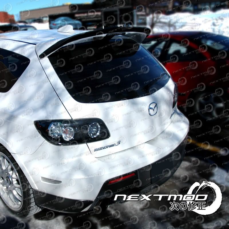

Does anyone know whose car this is? It's from the nextmod site and I was curious on the fender flares they added on to it as to where they got them from. I was thinking about a subtle flare on mine and wanted to ask this person.
also searching for this car, also from nextmod because I have been desperately looking for rear flare add ons for years and wanted to see if they have more pics of these:
no rear flares? You got mud flaps tho, thats something that can also go where the flares are. But flaps would be pointless in the city tho. I'll never understand why people have flaps, especially the subarus if they are rolling in the city where there isn't any mud and it hardly ever rains.
