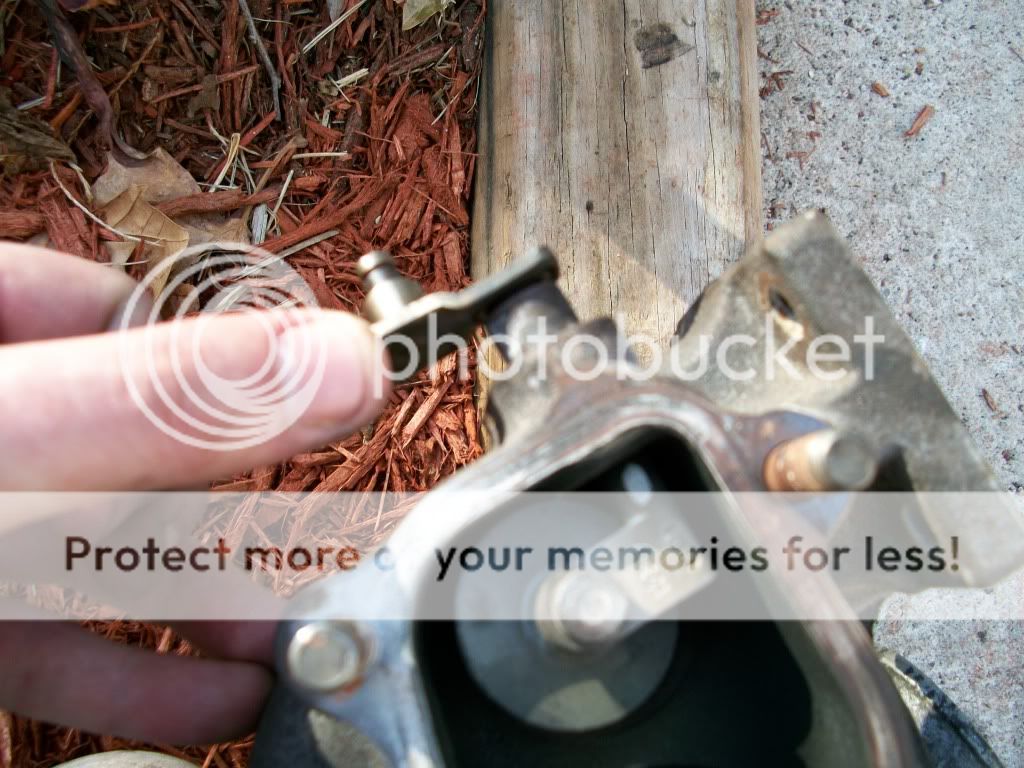

Yeah, it was a stuck wastegate. Wouldn't seat against the housing. Removed, repaired, and installed in a couple hours.
yea how did you repair the wastegate flap? My issue is during the day When I 1st drive it the power is decent boost is maybe 5-6psi. but after a while the will only boost 1-3psi and the turbo is not whining as loud as it usually does. However at night, when it was colder, she was boosting around 7 or 8psi whenever I asked and. I did have a exh. manifold bolt missing on the upper left side, so I replaced it. Now the upper right bolt is missing.
The steel sleeve that goes through the turbo housing had somehow (gotten really effin hot I guess) move about 1/4" out.. I took a torch and heated the housing up and hammered it back in. After I got it back to where it should be (there were witness marks) I took a punch to the turbo housing to help make sure it wouldn't happen again. I manage a large independent import repair shop, so I had all the tools and equipment I needed right there and had it done in less than two hours. I thought about taking pictures, but was in a hurry. I'm on my phone right now, but when I get on my computer I'll try to show you what happened/what I did to repair it using pictures I find online.
Uploaded with ImageShack.us
I just grabbed one of the turbos I had lying around so I could show what happened.
here is a better picture... yes this my turbo and I never built full boost tell about 4k
I can confirm that this issue happened to my car as well. No full boost till ~4000-4300rpm. Can visibly see the rod sticking out too far with an inspection mirror and a flashlight.
Has anyone figured out a way to fix the wastegate sleeve without taking the turbo off?
It took me literally less than two hours to R&I the turbo and get the sleeve back in. Not a huge deal. There's no way in hell that you're ever going to get it fixed without it being off, so just remove it.
