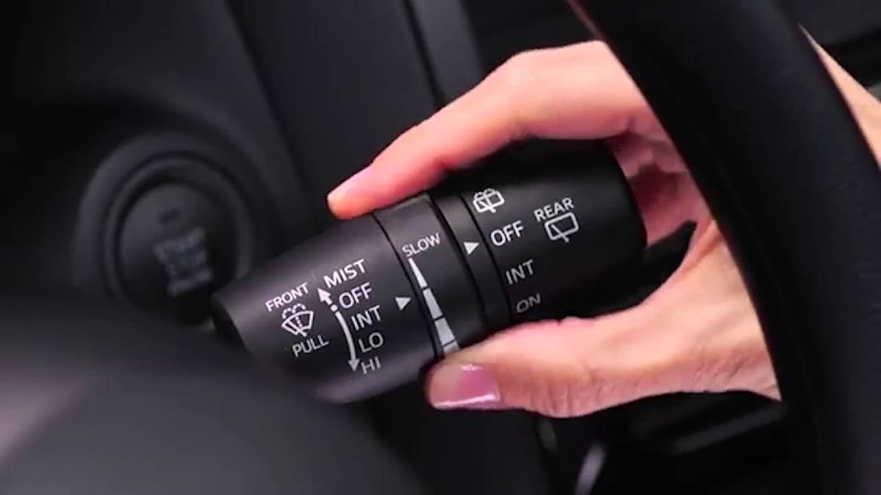

I'm only suggesting this video as the car is fairly new to you and your wife. It shows the basic operation of the windshield wiper stalk.

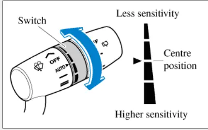

Does your model have auto wipers? If so, auto replaces the intermittent setting and will only run when water is detected.
Thanks for the reply. I think it may have the auto wipers. There is an assembly on the windshield next to the rear view mirror mount. So, if this car has the auto wipers, then the variable control on stalk adjusts the sensitivity of that mode? Is that correct? If that is the case the auto wiper mode isn't working as I've driven the car in the rain with the wipers set in intermittent or auto mode and other than the initial pass when turned on they don't do anything until I move the control to either low, high or turn off the intermittent/auto mode and turn it back on. Any suggestions on a fix?
Upvote 0
Start car an set wipers to auto, then splash some water to windshield, then it should work.
Remember you can set sensitivity om stilk, and remember to enable auto in HMI.

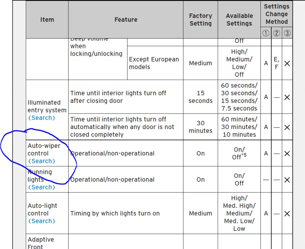

Not sure about 2016.5 but on the 2019 with auto wipers you can disable auto mode in the infotainment settings which basically makes the wipers variable. I do this when I get snow accumulation on the windshield which confuses the auto setting sometimes.
Upvote 0
In the second Generation infotainment system you can choose between intermittent and "rain sensing". I changed mine to intermittent because the rain sensing isn't as hyper vigilant as I prefer (I think my preference is in the minority).
