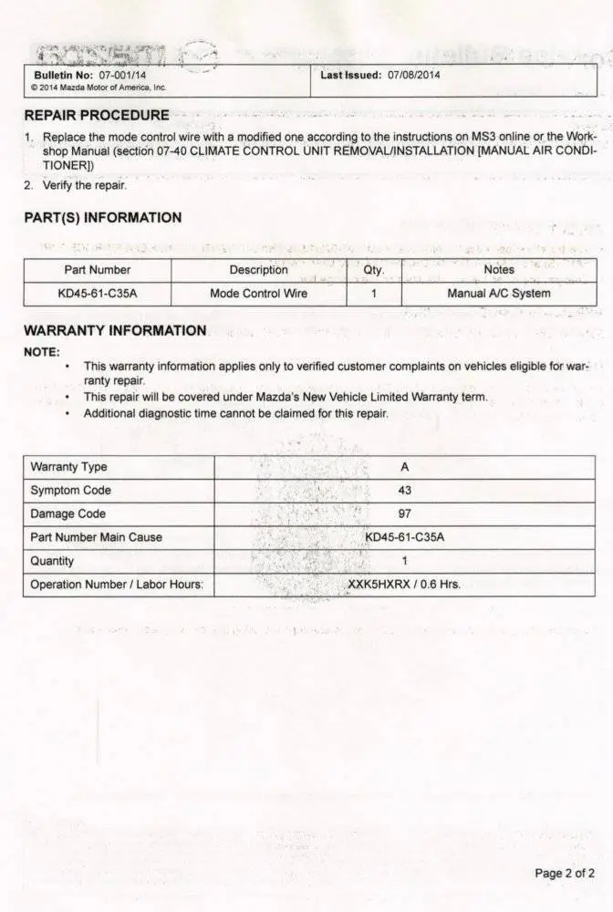

Here’s a TSB which is more related to the problem here, where Mazda had modified the length of a cable for vent selections, but only for manual AC system.
TSB #07-001/14 A/C MODE SELECTOR DIAL DOES NOT STAY IN "DEFROSTER VENTS" POSTION - (MANUAL A/C ONLY)
