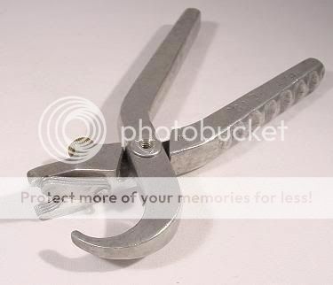

Ok so I got my order of the 1 step colder plugs. I went to gap them and they are all set at like .037 already. Is there a way to pull it back out a bit?
I know, I know probably a stupid question so please forgive my ignorance. I have never ran into this issue.
I always use the tool thats on the end of the feeler gauges. And preferably you want to use the wire feelers not the traditional but thats me trying to be a perfectionist.
Hands down the best kind of gapper. Prevents any scoring on the tip...which can lead to hotspots in the cylinder.
the thing to keep in mind when you gap spark plugs is that you must keep the metal tab parallel to the flast side of the electrode, when you start tapping them to close the gap they tend to go crooked , meaning that the distance between the electrode and the metal tab is different at different points. I understand the electrode is the size of this "o" but you would be surprised how much weaker the spark will be if they are not parallel to each other. anyways old school advice.
Jacobs Electronics used to make a plug gapper than positively keeps the electrode aligned while gapping. I have one but dont know if they are still in production.
