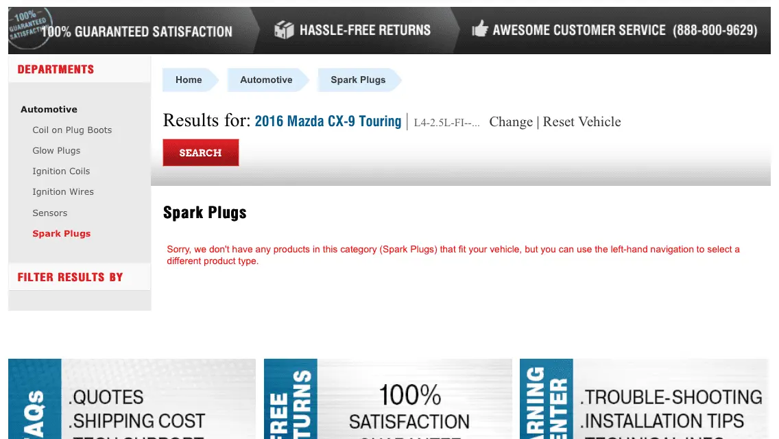

Denso: "Sorry, we don't have any products in this category (Spark Plugs) that fit your vehicle, but you can use the left-hand navigation to select a different product type."
