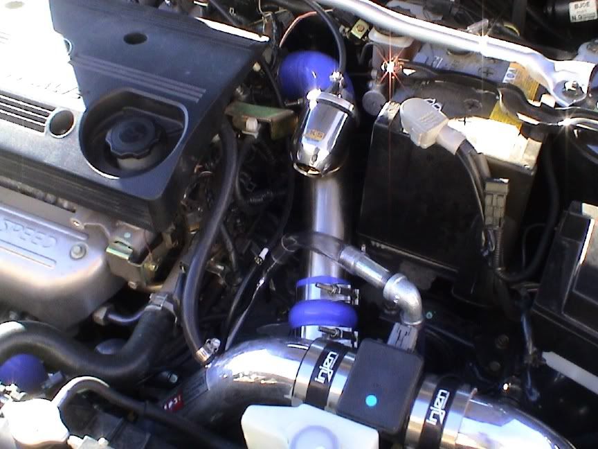

Here is a pic of someone who mounted their BOV near the Throttle body, and kept the BPV:
Just wondering if this would be a good location for the BOV. I'm getting a lot of feedback in regards to placement thru threads and PM's. I hate how modd'ing is never straight forward with any car I buy thats foreign, I swear things seemed sooo straight forward and simple when I had a chevy truck. All I want to do is eliminate the turkey and add a little better performance. I thought aluminum hardpipes and an aftermarket BOV would be an easy and simple way to resolve the problem and make the car run better. Now I'll be running into stalling issue's by adding a BOV... lame. I do intend to keep the stock BPV on their, hopefully that'll help any stalling issue.
doing the dual will not give you stalling issues, you just have to monkey with the bov so it doesnt open too early thats all
