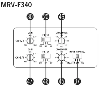

Thanks for your patience in explaning things. But I'm still not too clear on the high-pass low-pass issue (specifically, the inability for the amp to do so) that you stated in your post. I had an impression that the amp in question can do what I needed to (i.e. high pass to front channels and low pass to rear channels). I've attached a small image of the manual... perhaps there's something I'm not understanding.

The amp can low pass the rears but Lowpass only is for subs not midbasses. Midbasses need a high pass of aout 70hz and a lowpass of about 500 hz. If you have a basic mid doinf only as lowpass it will distort and sound like crap as it can not handle that range of sound.
