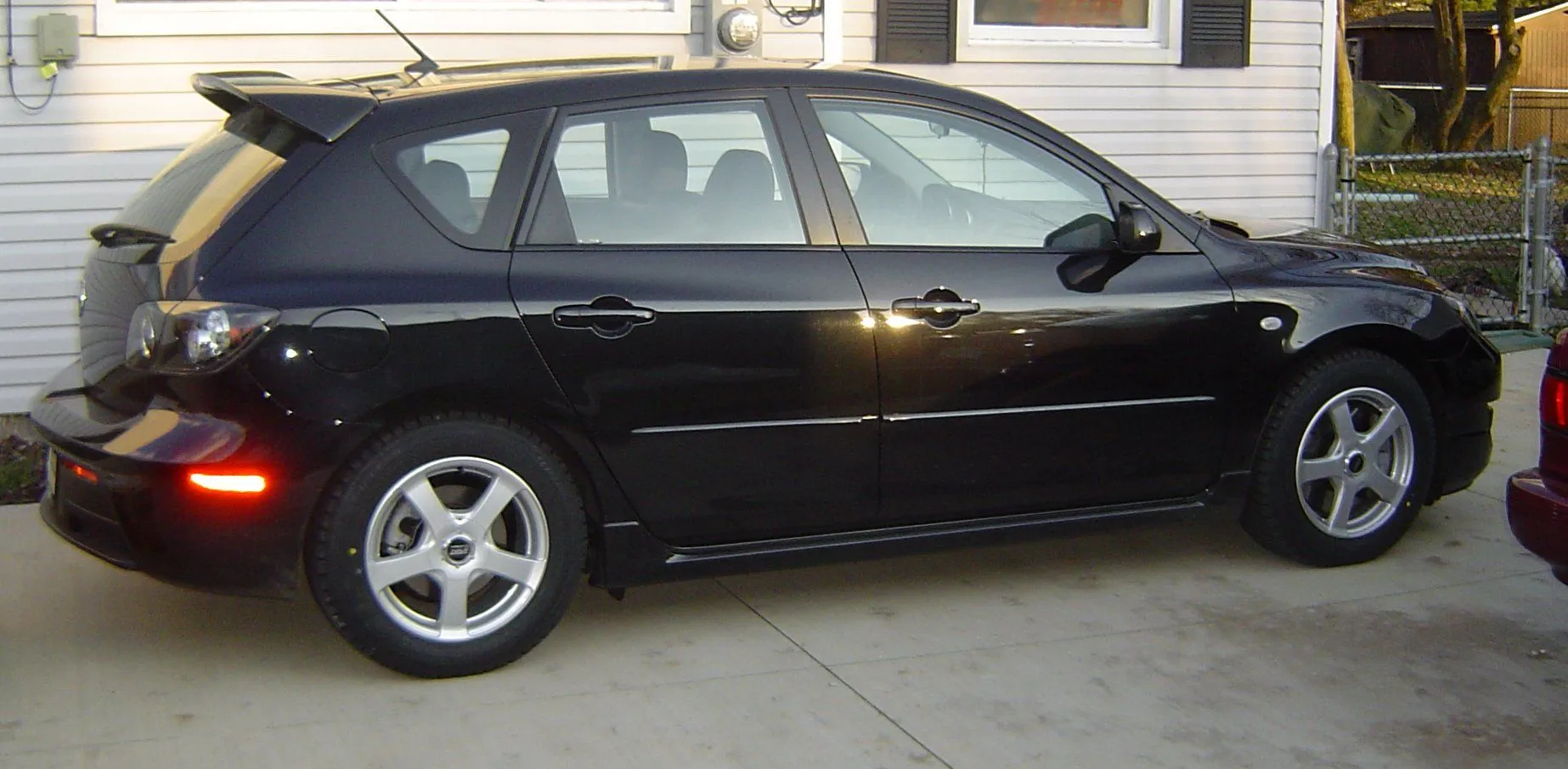

New wheels/tires on your MS3? - Post Here!
205/50/16
barely fit, but no problems. clearance is good all around.
the ride is great on the bumps. defintely going to go 17's in the spring with more rubber.

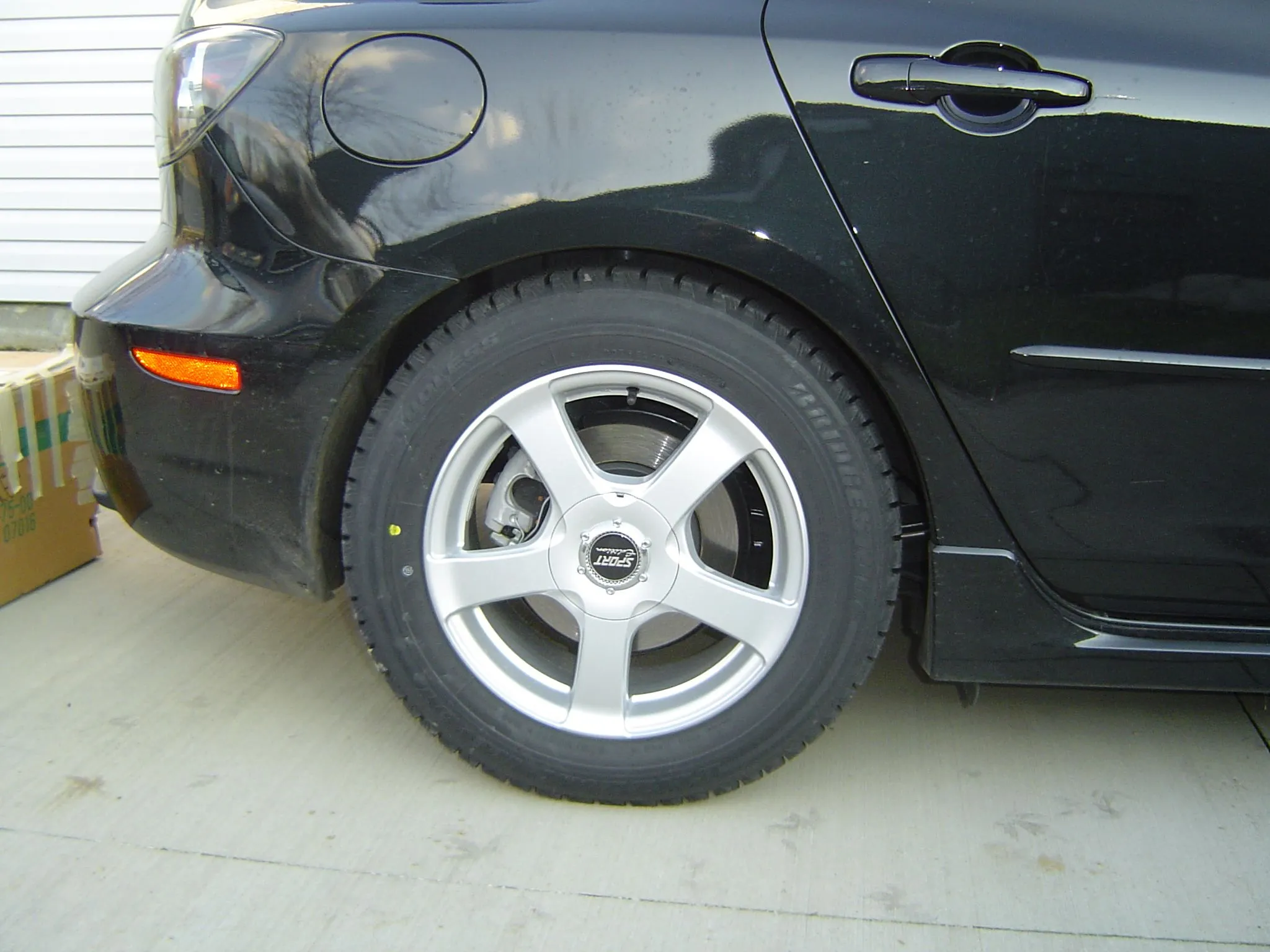

I went with 16-inch Sport Edition D4's with 205/60/16 Blizzak Revo's from TireRack - total package was about $807 shipped to my door. The combination of snow tires and higher profile make driving MUCH less fun on dry pavement, but it helped alot this morning during the first morning rush hour with snow and ice on the roads. It is a tradeoff I'm willing to make for safety in the winter.
Sorry about the poor quality of photos.

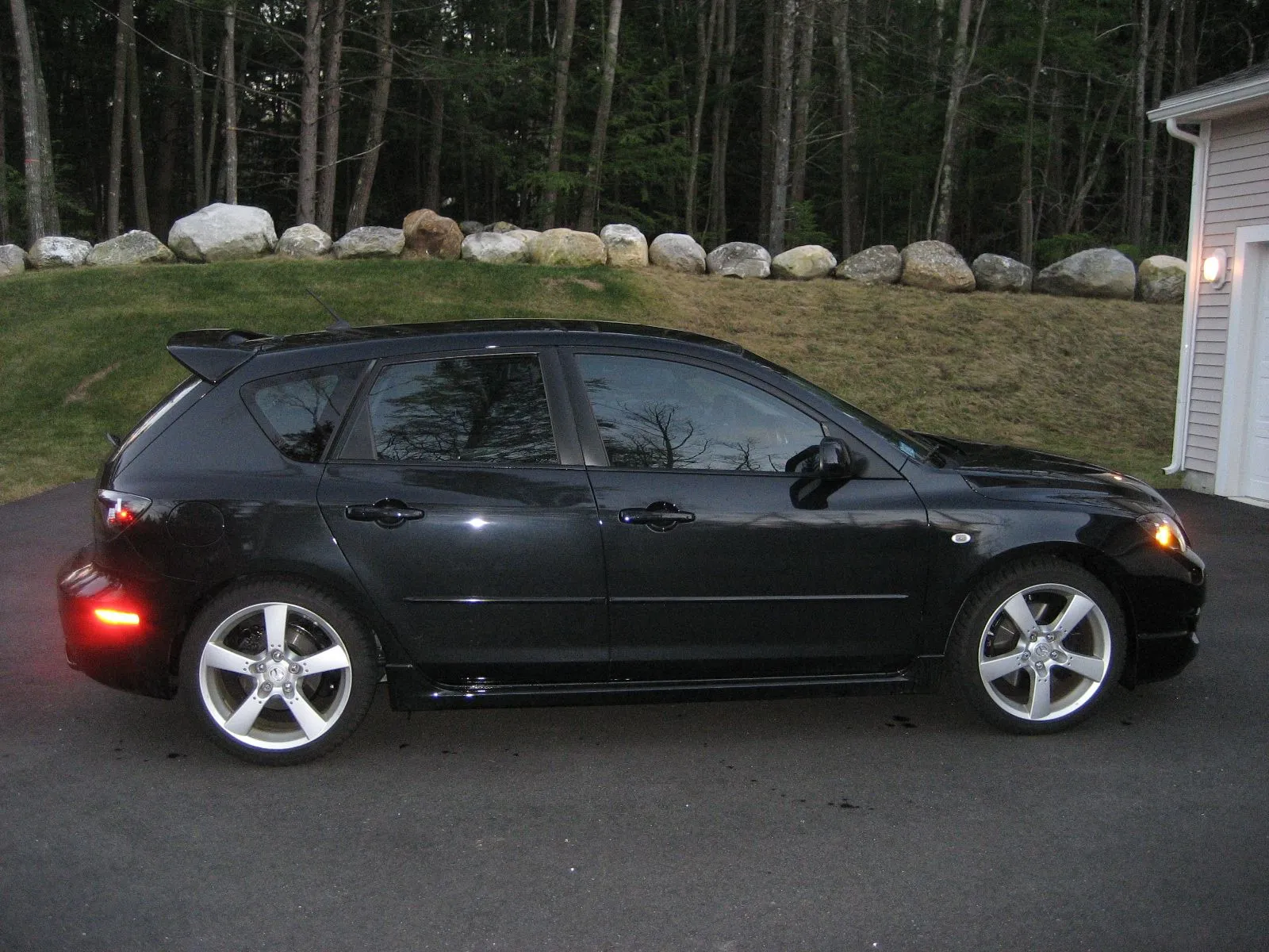

I currently have 225/45/18 Dunlop Wintersport M3s mounted on stock RX-8 rims which are 18x8 +50mm offset. This will be my 4th winter on these tires (3 previous winters with these tires on my RX-8) and they perform phenomenally. I stayed with 18 inch snow tires for the following reasons:
1. I wanted to keep the stock tire/wheel size when I bought them (I was driving my RX-8 in the winter at the time)
2. I wanted to keep the stock handling feel of the car.
3. I got a smoking deal on these @ $135 per tire at the time.
I live in the Boston area. Most of the time here there isn't standing snow on the primary or secondary roads. Usually it snows here and within a week or two its melted. If I lived somewhere that caused me to drive through standing snow more often, I would go down to 17s or 16s and get a more aggressive snow tire. The Dunlops have good snow performance and good dry road handling characteristics.

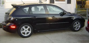

Hey I found a set of New Ford Fusion 17x7" rims on Ebay for $250 (local pickup too). These have a 43mm offset and they fit perfectly. I got the Kumo ECSTA's 215xr50x17 and they handle great. The ride is a little softer than the stock setup. I haven't tried them in snow yet, but the stock tires were like iceskates, so these should be way better than stock. I got the Kumo's for $390 delivered from Tirerack. So I have $650 in the whole setup. Here's a pic:
I think they look better than steelies and for $250 the rims cost about the same. If anybody wants a set the guy has more - PM me.
