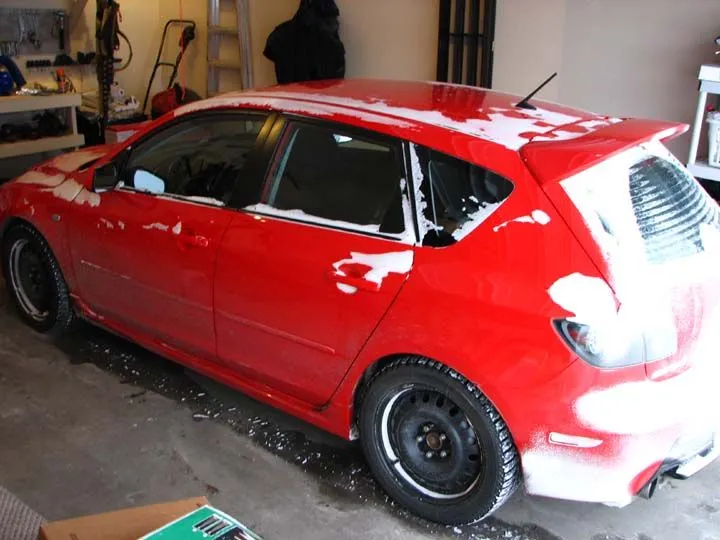

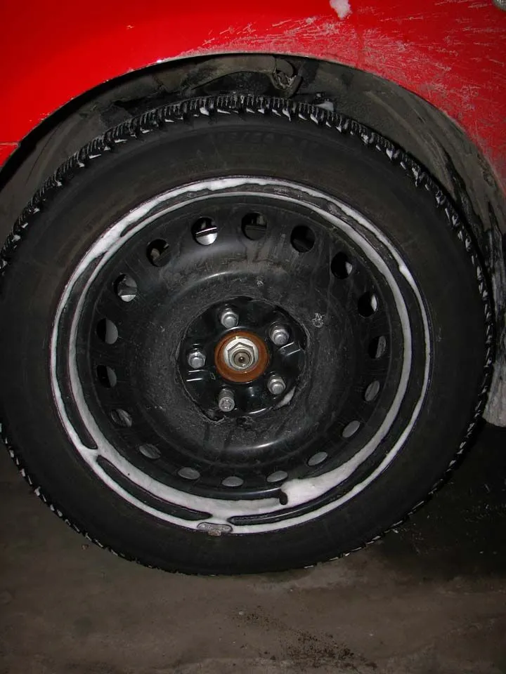

Hey already have the snow shoes on mine. Put a set of Michelin X-Ice 215/50r 17 . At the Tire shop they had a 16" wheel on it. I just didn't like the look. So i wen twith the 17" 50r to keep the same overall diameter..
