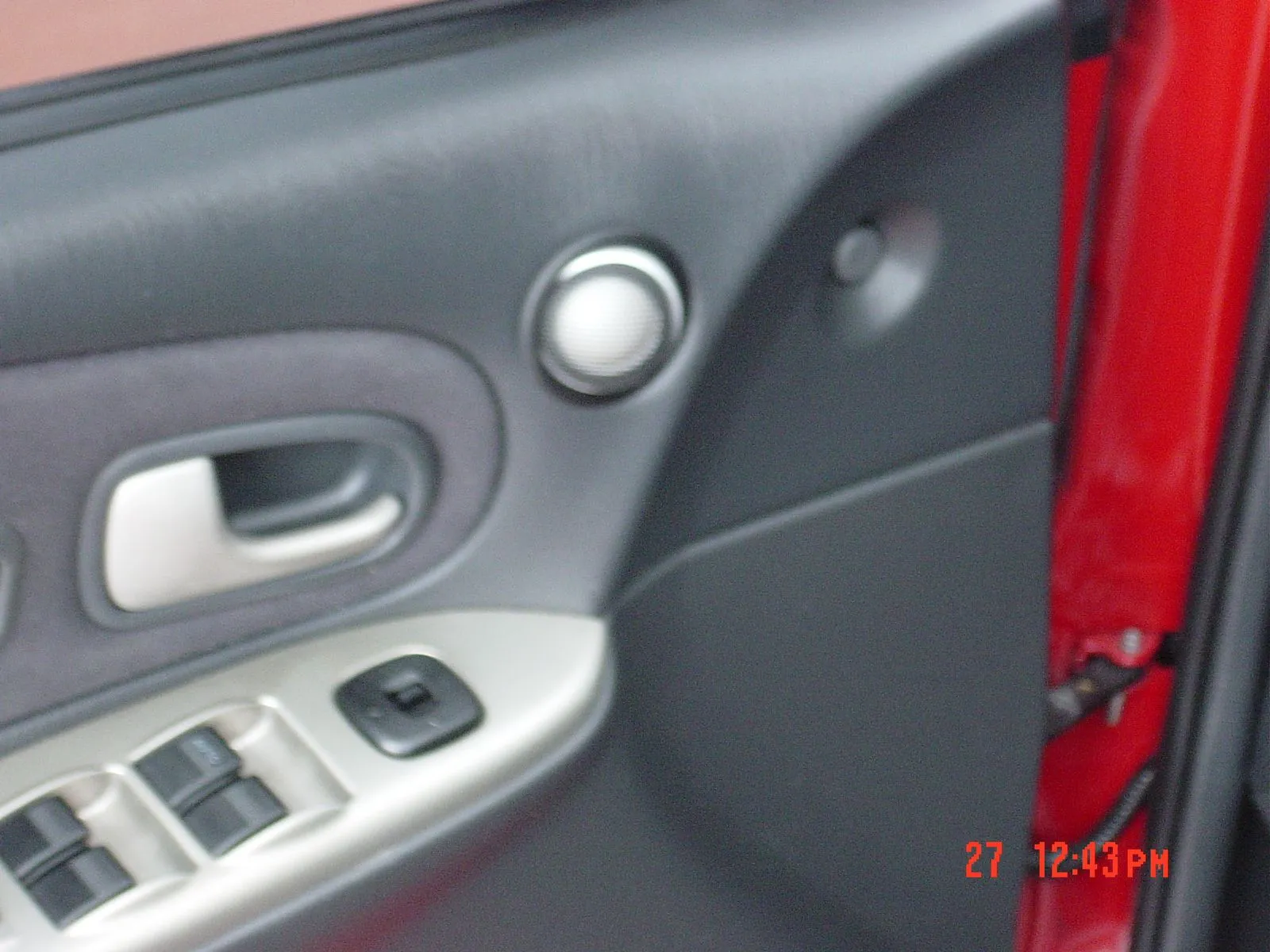

I really like Kappa's, they provide great highs with a amp.
Here are mine right on the door
Mine are in the exact same place. Kind of a b**** to install there though. I had to cut some metal out from behind to get them to mount nice and flush, but it was definately worth it.
