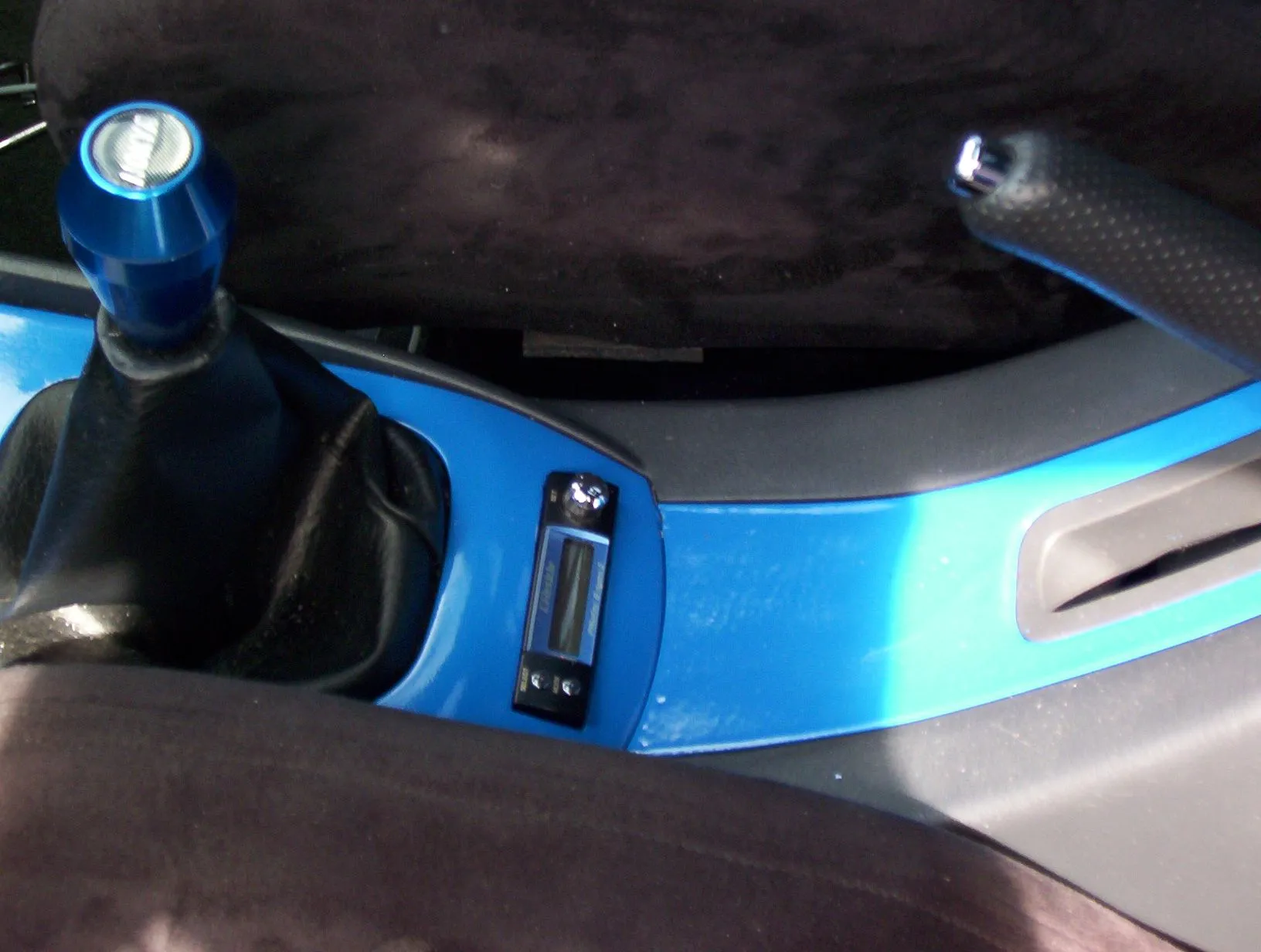

STEP 2: INTERIOR FIXED
here are a few of the interior.... yes it is dirty but you get the point...... the center radio surround is now smooth and the emergency flasher is taken out and the hole is smooth but you cant tell that due to the screen..... also that is where the nx bottle is going but i have not secured it their yet.... i have to run the nx line tonight.......

I run about 600 to 700 at idle and about 1100 to 1200 at full my ar is around 11.5 to 12 so still a little rich
right on so i am not that far off..... one last pic.....this one shows the sides smoothed pretty good
yes i did paint it black, it was a b**** but it worked........ i dont recomend anybody doing it because you have to take everything apart....
