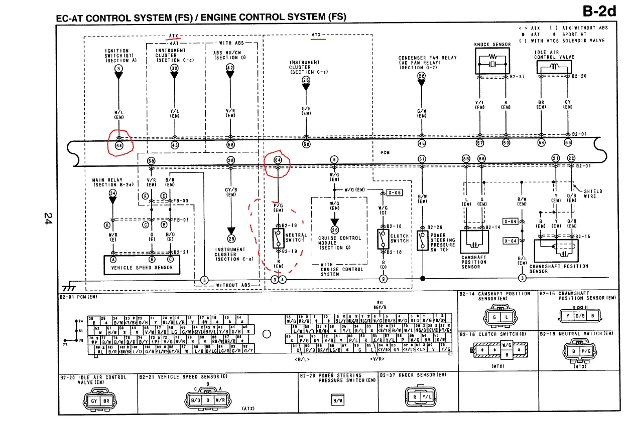

So I ended up swapping out my old manual ECU with the auto one as well as the instrument cluster, based on a good P5 expert friend's advice (the ECUs are in fact different).
Now I'm seeing an odd issue where the engine jumps up to an idle of 2k rpm on a cold engine and about 1500 on a warm engine only when the clutch is in AND the car is in gear (e.g. neutral switch related).
Image below of the rewire I made:
I'm gonna dive into it some more after the holiday, but I'm pretty sure some additional rewiring needs to be done with the harnesses...

So as mentioned in my past posts I ended up swapping theamual transmission into the car along with the manual ECU and cluster, all from a 2002 P5. It took a good bit of wire harness rerouting, but it finally works fine! I tested the dog snot out of it after fixing the 2k idle issue (which was happened because I forgot to rewire the neutral switch to the correct, new ECU pin) and actually got it inspected for rebuild, titled and sold! So she's gone and I'm on to new projects (threads coming soon).
