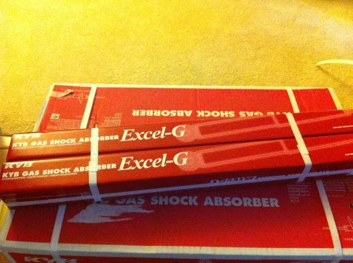

The 9 always vibrates at highway speed even the tires are balanced. I took it to a tire shop recently to do a road force balance. The tech told me the struts and shocks are shot which caused the tires to deform. The car has 75K on the clock. I have also checked with my trusted tech and he said the same thing. He also found that heavy hauling has caused more stress on the struts/shocks and tires.
I have ordered the KYB GR-2 gas struts from Tirerack and was wondering if any of you have first hand experiences on them.

Yes I did get the KYB shocks/struts. The ride and handling is about the same as stock; can't feel a major difference. I am just waiting for the cupped Toyo Proxes to wear more before I slapped on the Yoko Paradas (sitting in the garage) on. Rule of thumb. Rotate and balance your tires every 5000mi to prevent cupping (boom06)
