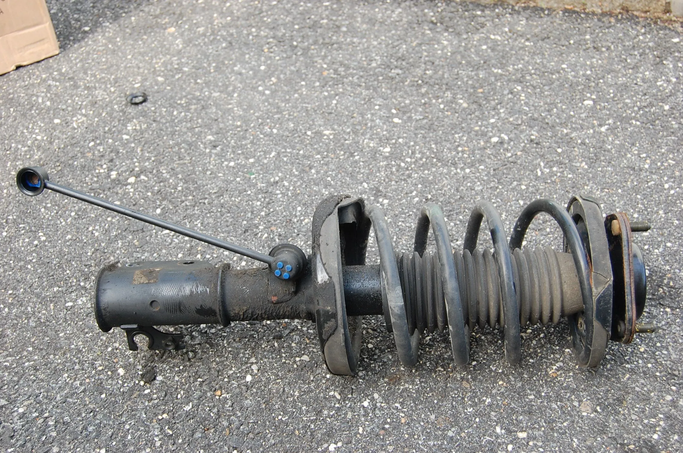

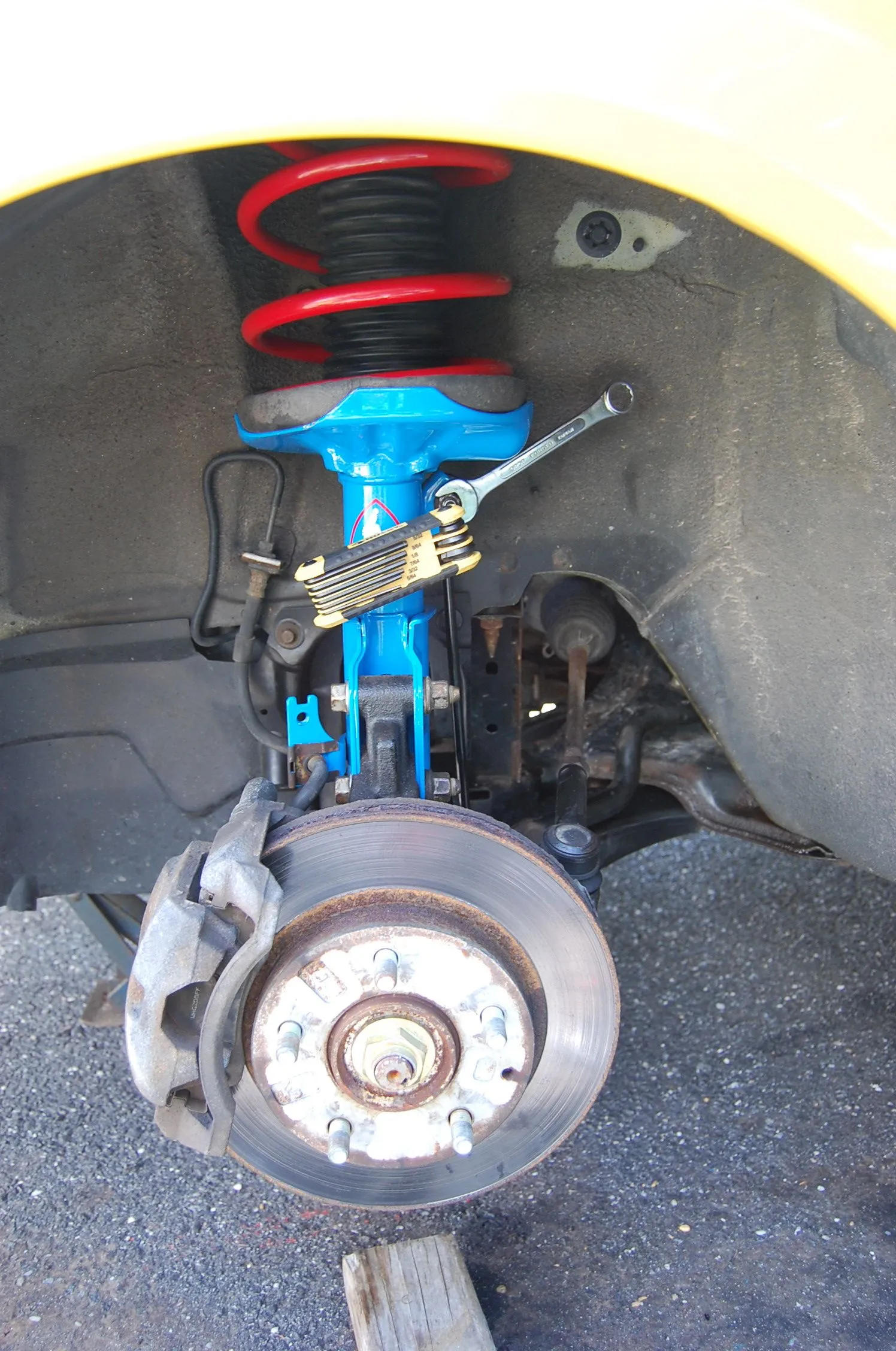

I just did springs/struts myself. I opted for the Tokico kit from ProtegeGarage.com. 500.00 bucks for all 4 springs & Tokico Blues. Can't go wrong IMO ! As far as the install, I'd give this advice:
1. Soak everything with wd40 or PB blaster etc. several times before you dive in, you'll be happy you did.

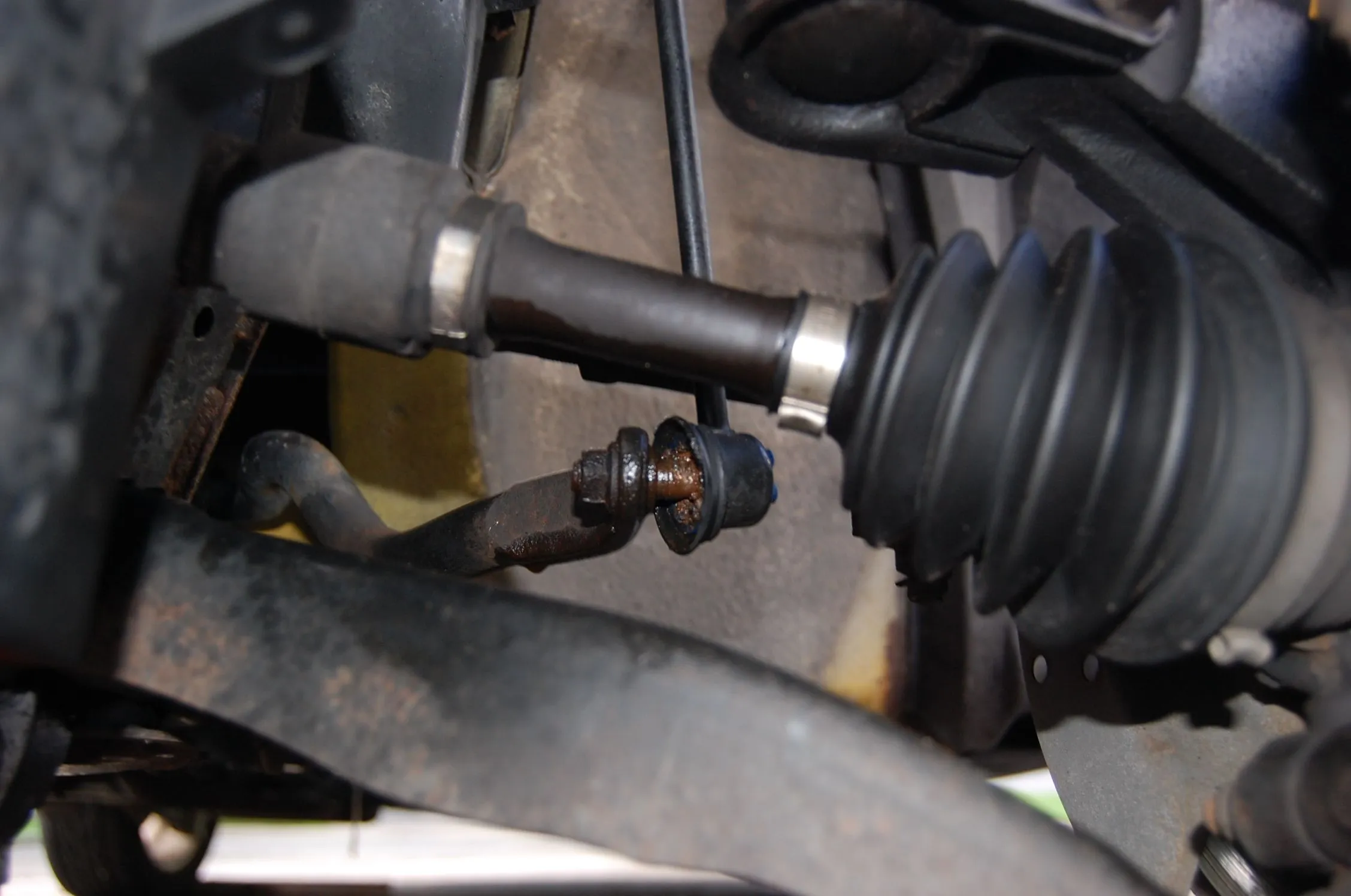

2. Order yourself 4 new end links, I had to cut all 4 of mine off. They were worn out as well (and all my clunking noises are now gone!)
3. Don't forget to buy/rent a spring compressor
4. I had to remove the pass. side rear caliper to get one strut bolt out.... so soak those too. I snapped the caliper bolt and wasted an hour with that mess.
It took me about 6 hours all together, once I gave up on unbolting the endlinks and got out my cutting wheel, it went very easy. Have fun.
