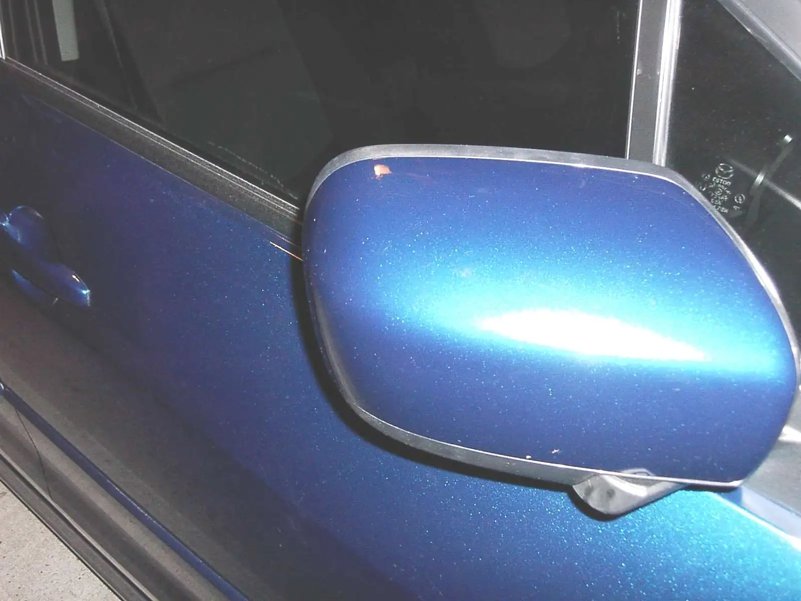

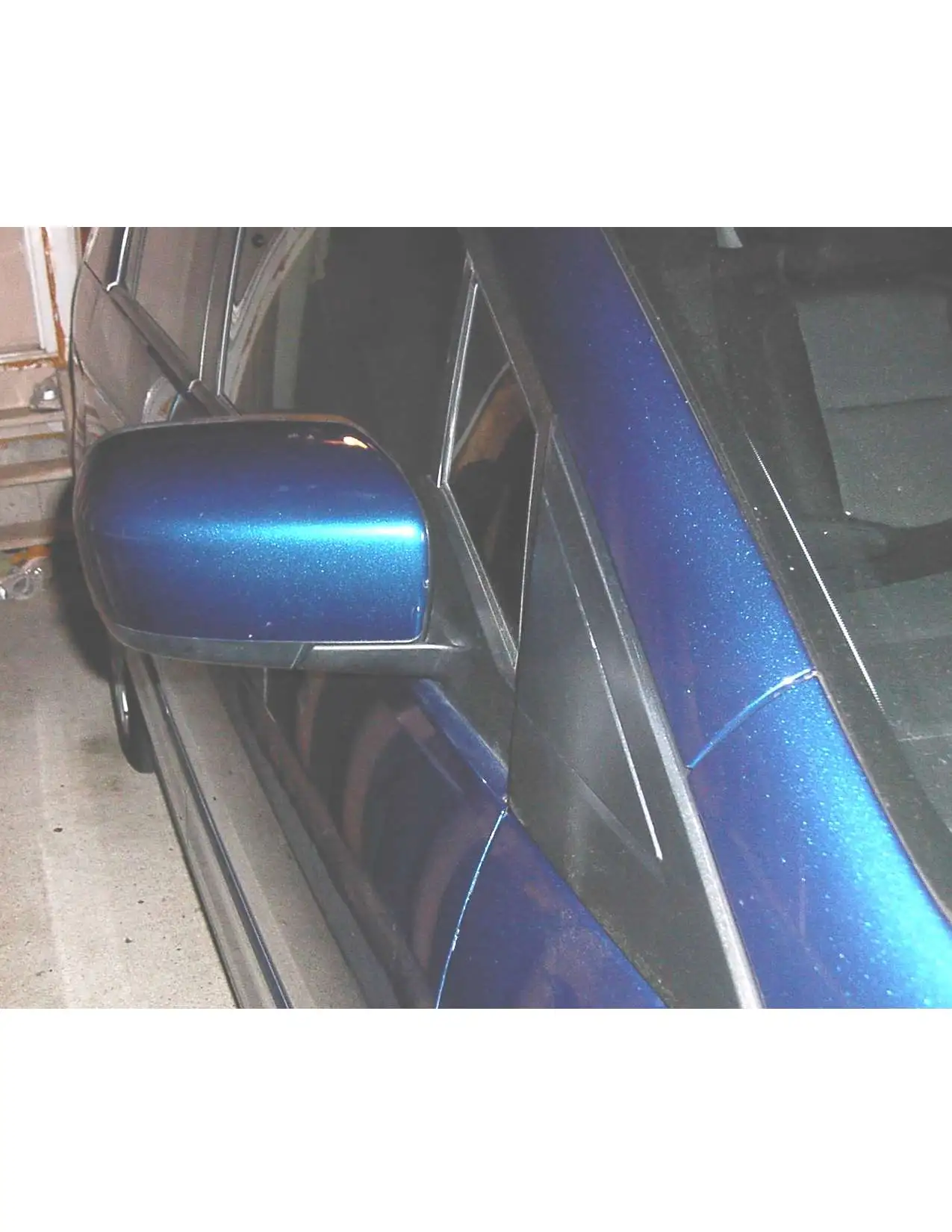

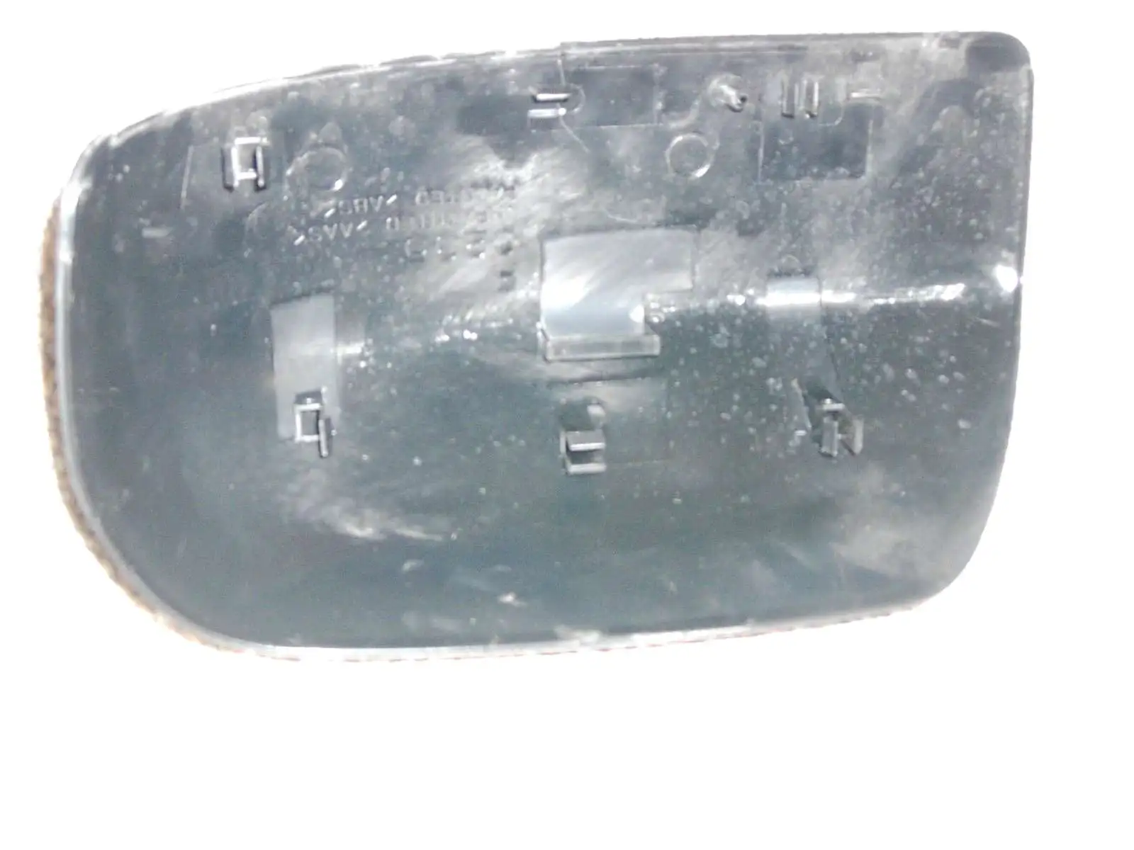

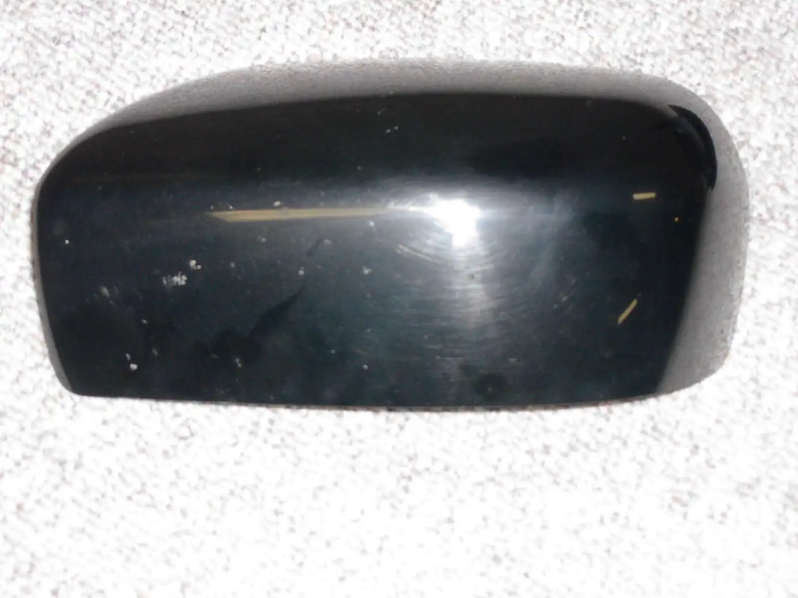

Heya I know this is not the best change goin but some of us where stuck with color painted door handles with black side mirror covers(GS models in canada....GT have color matched painted covers). Well I found a solution.
I ordered color keyed covers from my dealer and changed em in 20 minutes. Really didn't take my time removing the covers but you could take more time if you release the clips behind the mirrors.
Total cost about 50 Bux Canadian for both.
I supplied some pics but will add better pics outside when I get a chance.
BTW I discovered a bonus: When the cover was off my mirror was wired for HEATED mirror... this is not an option on a GS in canada so I will find out where that wire goes to connect it and get bonus side heated mirrrors
