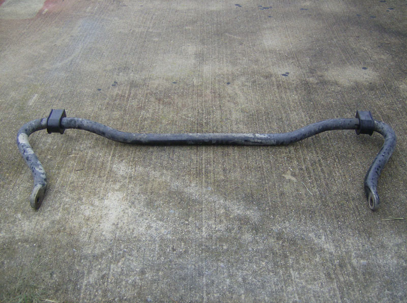

I would never install that. Who would ever install a swaybar like this with welds on it? Antiroll bars, need to be one-piece cromoly castings otherwise you're just asking to snap that thing at the welds.
This is a good example. One piece, easily twisted over and over again without any welds to break. Single piece of metal.

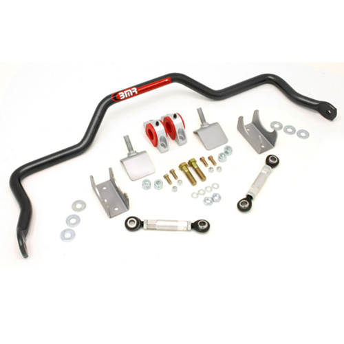

3 pieces, not welded anywhere...considered one of the best in the industry. Link to PDF
That would be a perfectly acceptable solution! Bolting it all together and simply twisting the hollow bar (or solid) is preferable to twisting a welded point (crystalized metal, no ductility).
