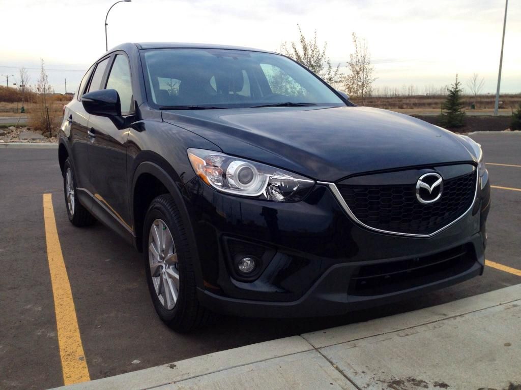

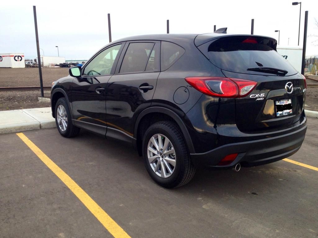

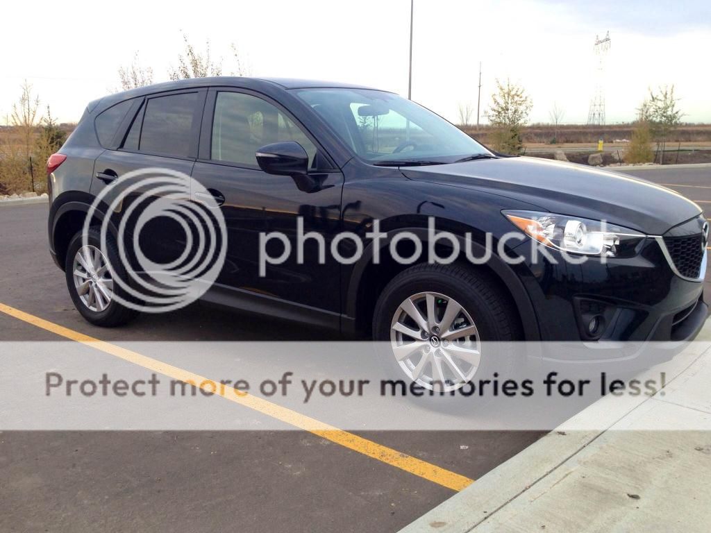

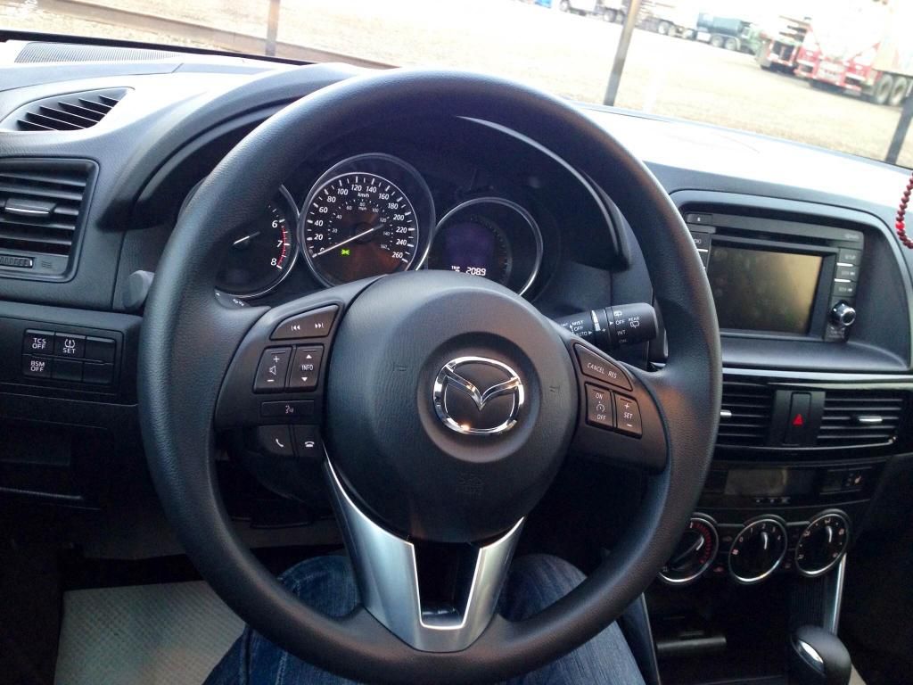

Many thanks and here is a few pictures of her,
