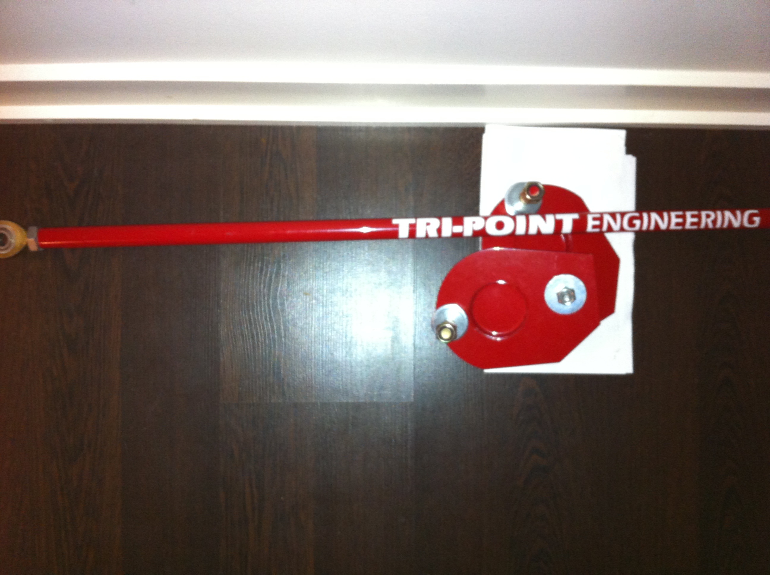

So I've made the decision of going to STF directly. I ordered the adjustable tri-point RSB and a pair of camber bolts. Next I'm looking at the shocks / coil over options. Do these fit on our cars and would they be a good option?

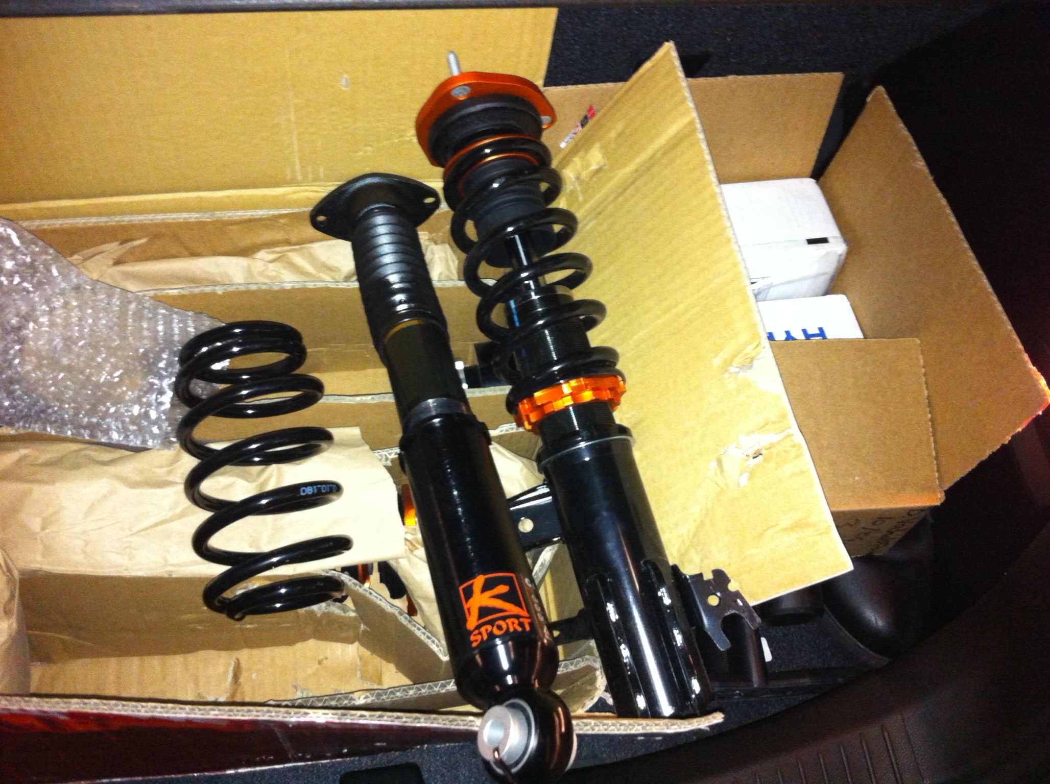

Honestly the Corksport adjustable dampers (paired with Corksport or other springs, H&R, Eibach...etc.) are a great option for a budget minded set-up, you can always upgrade later as your budget and competitiveness level increase... :)
Several serious Auto-x people here have even had good luck with the K-sport coilovers. Really it just depends on what performance level you are looking of verses what you are willing to spend...
I was considering the K-sport, based on it's popularity but noticed that they come with really soft springs rates (280/170) and to replace them with heavier springs would probably cost the same as the fiesta B-spec coil overs... they come with stiffer springs out of the box 450/500.
I'm neither just a novice nor after being a national champ, just somewhere in-between. I'll probably take the car to NT but not nationals and my local clubs are very competitive with a few National champs. I've had ASTs before and I know their quality is great but can't justify the price... looking for the next best thing.
I suspect that the fiesta coilovers would work fine but if not, I'll be going with the K-sport and stiffer springs.

they do fit, but in order for it to be STF legal you need to remove the springs from the rear strut and mount them at the OEM spring perch location. Another forum member did this a long time ago and had a few pictures but i don't remember who.
Get the K sports, buy 2 6K rate springs for the front ang place the factory front ones (5K) in the rear, enough to beat a national level autocrosser.

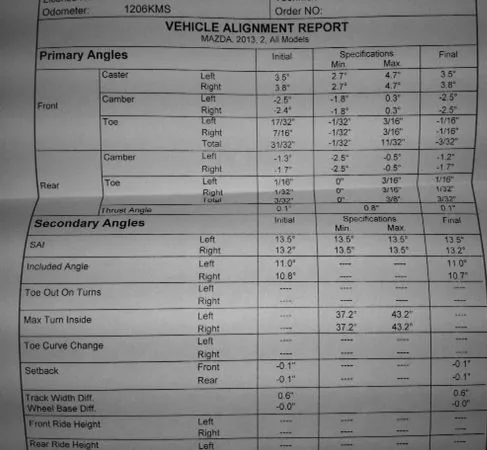

Got my first alignment done prior to our winter series starting. I think this should be a good starting point but feedback is appreciated:

I always ran zero toe up front on the street, and then spun one tie rod one turn for events only (steering wheel will be cocked to remind you to put it back).
That much camber combined with toe out on the street will prematurely wear your tires if you do much street driving. W/o the toe out, the camber is not nearly as hard on the tires.
I always ran zero toe up front on the street, and then spun one tie rod one turn for events only (steering wheel will be cocked to remind you to put it back)..
That's a very cool way to do it! I'm going to try it your way once I get the coils and get realigned, meanwhile I'm going to be doing around 1000km of DD... I think the wear should be okay?

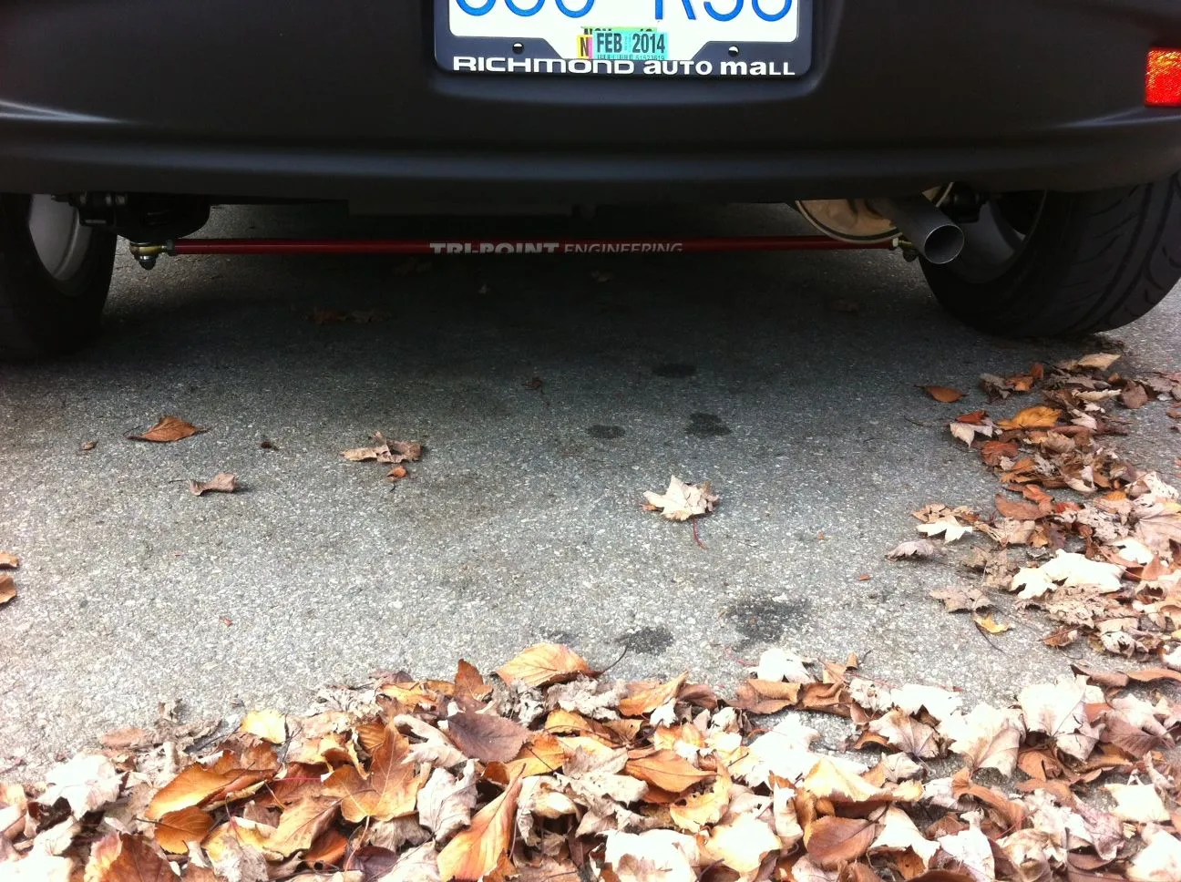

Done with the rear:

Does ST allow interior panel modification to access the rear shock adjustment? I can't find it in the rulebook... it does allow modification for a rear STB installation but for that purpose only. How are people adjusting their rears with the K-sport?

The allowance for shock adjuster holes in the plastic inner trim panels (not steel body structure, though) is inherited from the Stock category.

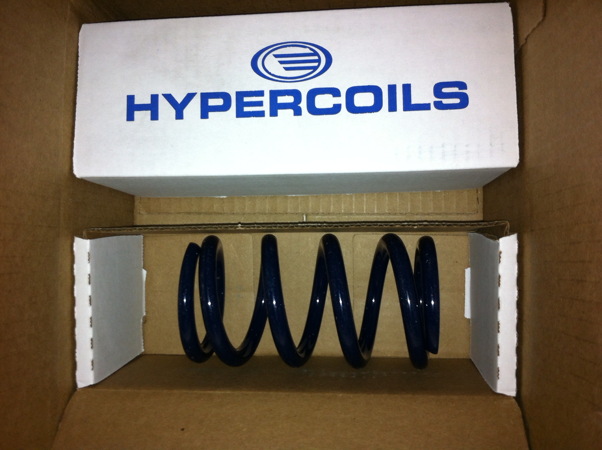

Car lowered with K-sports front and back. 450 hypercoils in the front and 350 H&R in the rear both are 6"... might consider stiffer and shorter in the rear if I get too much understeer. The front is lowered as far as fenders allow (which also helped with my endlinks that were rubbing on the fender wall before). The rear has just short of an inch to the fender. I'll be posting pictures.
Alignment was interesting... I'm getting less camber than before... guess control arms are pointing up and pulling the wheels closer together.
The other problem I noticed was that I have alot of toe in... not sure if my tripoint rsb is responsible or not? If so, should be easy to adjust it to get closer to zero... does the adjustable RSB affect toe at all?
