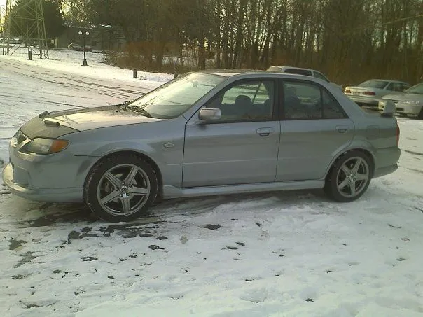

Bought a MSP a couple days ago. It has 117k miles, and some strange issues. It makes a noise when going over some bumps from the right front wheel well. It sounds like a grinding noise to me, but I don't see anything that would rub. It also has a strange hesitation/stalling problem which I think is due to a bad FMIC job. The tubing from the bov seems very suspicious. Don't have many pictures yet and I haven't had any time to give this car a thorough run down. I also smell oil when coming to a stop, I hope this is just the o-ring and not a serious motor/turbo problem. Any advice you guys can give would be greatly appreciated. It also seems like the front of the car is sitting higher than the rear, dunno if you can see this in the picture but it is noticeable to me in person.

Why do you think it is that? The motor mounts look good on this car, but I will check them more closely, they are aftermarket mounts, which are red.
Welcome to the forums and your new MSP..my car looks higher in the front too, dunno if it's because of the subs I have in the trunk or what. That's why I can't wait to swap out my struts and springs. Does the car have an aftermarket exhuast/maybe catless?..because with a catless exhaust, you will get a whif of a burning smell when you come to a stop as the fumes drift past your car. As far as the noise you hear going over bumps, I wouldn't know. and the hesitation you are getting may be because of the stock tune on the ECU. This car runs rich from the factory. Search the forums and you will see what I mean. Everything you will need to know, I guarantee you will find on this forum. This is lots of info available on here. This may help you a little bit: http://www.mazdas247.com/forum/showthread.php?t=50549

I checked the WGA and it is no good. I can blow right through the vacuum line. Also the car is definitely higher in the front, and I'm kind of confused about this. It appears to have stock suspension, but the front sits about .5" higher.
