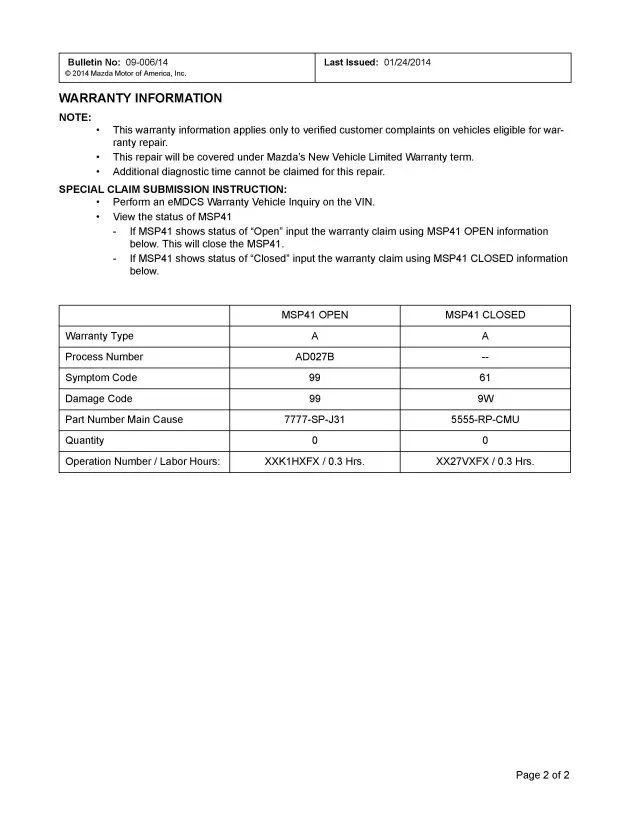

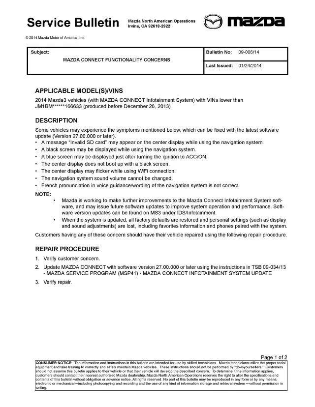

The images that you posted specify an update for the 2014 Mazda3 with MazdaConnect, i.e. the infotainment with the fixed, dash-mounted screen. It does not apply to the CX-5 at all. But thanks for looking for a TSB.
I FOUND THE TSB!!!!!!!!!!!!!!!!!!!!!!!!!
UPDATE: Ok looks like this new TSB is for MSP41 update (dated 1-24-2014) , I'm still looking for MSP42.
Applies to all 2014 CX-5Two jpgs attached below:
ugh. i just realized that, opps. I was looking at a bunch of tsbs and my eyes kept seeing cx-5...
