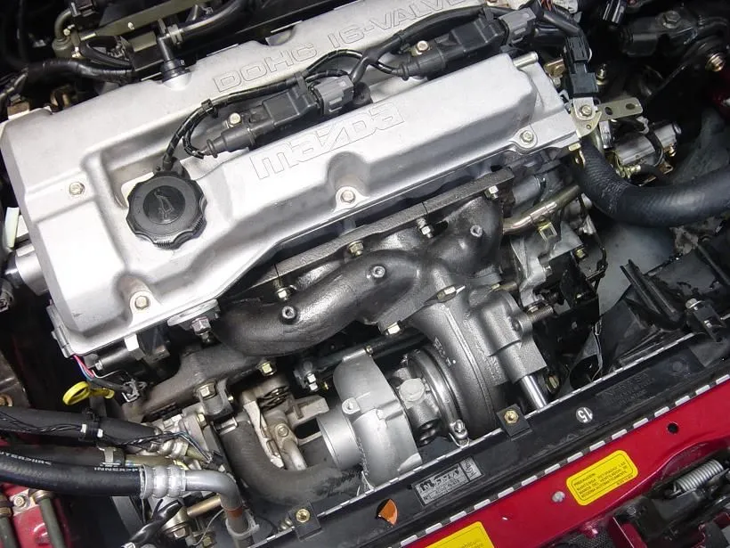

Well, You will not believe what kind of power this little beast can make.
Here is the picture of the kit with even a better turbo. An IHI VF24 was used in this car and made 201 WHP at the same 9 psi the GT25R made 178 WHP.
We did hit the boost level of 20 psi, however the Map in the Haltech is maxed becasue we use a 2 Bar MAP that takes only 15 psi of boost and then when using the boost controller from Haltech, the ECU will automatically drop the boost to a safer level. That is why the dyno curve will look with a big drop. Tomorrow we will install a 3 Bar MAP sensor to get the maximum. Here is the video.
And a picture of the IHI Turbo in place.
Incredible 270 WHP of a 1.6 liter with stock internals. The car has only 1000 miles.
