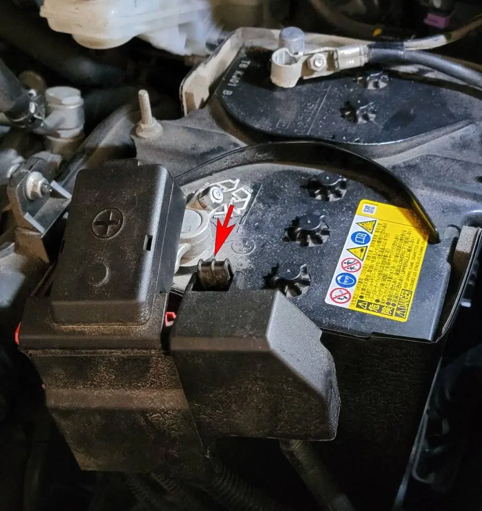

To get the black terminal cover off the positive terminal, flip the cover off of the terminal, then squeeze the retaining clip in and lift the whole cover up while pulling towards you.

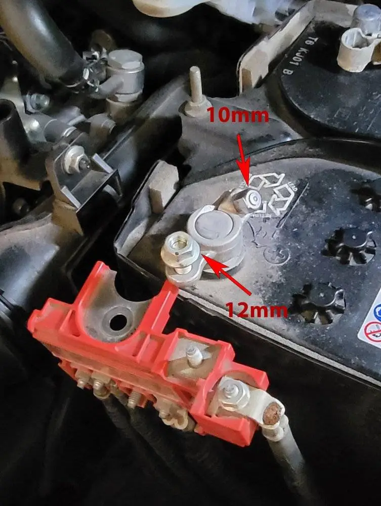

This may not be necessary for everyone, but for me, the clamp wouldn't come off the positive post after loosening the 10mm nut. I used a 12mm socket to remove the nut that holds the red bracket to the terminal clamp, then lifted the bracket off the clamp and wedged it under the air intake piping. With the red bracket out of the way, I was able to twist the clamp back and forth until it came off.
