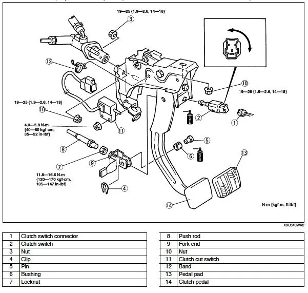

There are two switches in a manual tranny Pro ( clutch pedal assembly.jpg):
1. The clutch switch. This is located further into the cabin, and the plunger goes into the switch body when the clutch pedal is up.
2. The clutch cut switch. This is located further toward the engine, and the plunger goes into the switch body when the clutch pedal is depressed.

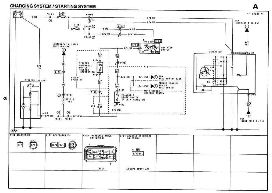

As you can see from the starting circuit diagram (starting circuit diagram.png), the circuit is formed by the battery, starter, clutch interlock switch (clutch cut switch), ignition, battery, and associated wiring/fuses. If the starter bench tests ok, the clutch cut switch checks out, and the car still won't start, look for corrosion on the wiring between the battery and starter.
