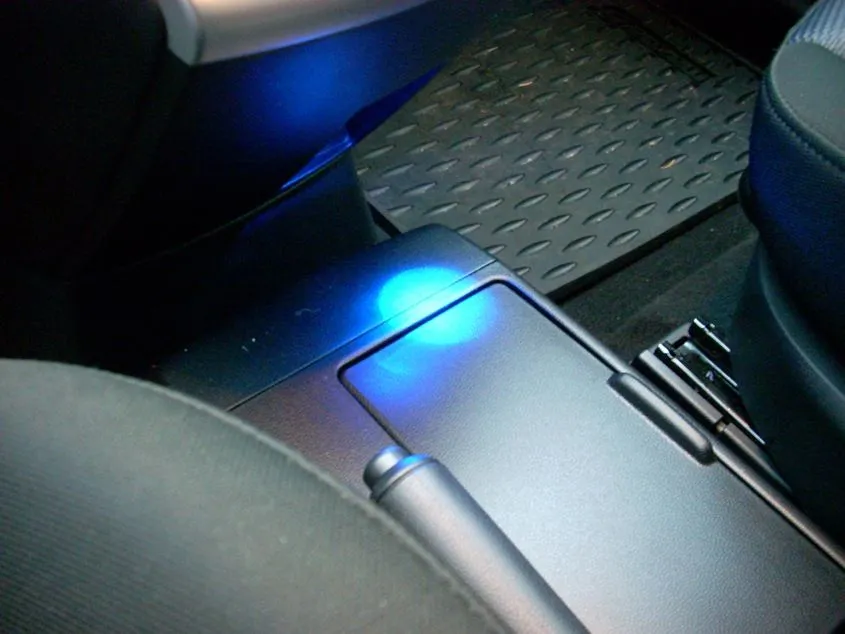

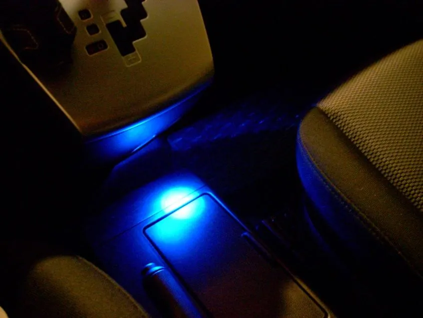

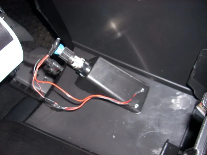

i put two LEDs in the upper area of the pocket for the front power outlet to light up the drink holders in the center console. worked very well, except the right LED was more over the passenger floor because the pocket itself is off center. So I put a piece of electrical tape over it (hack!). Here's pics of them wired in and what they look like in daylight and night. I am going to replace the right LED with a pushbutton switch for the remaining LED.

^^ cool, but get some green LEDs to match the interior lighting. i would have done it but the blue ones were there in front of me and on sale.
