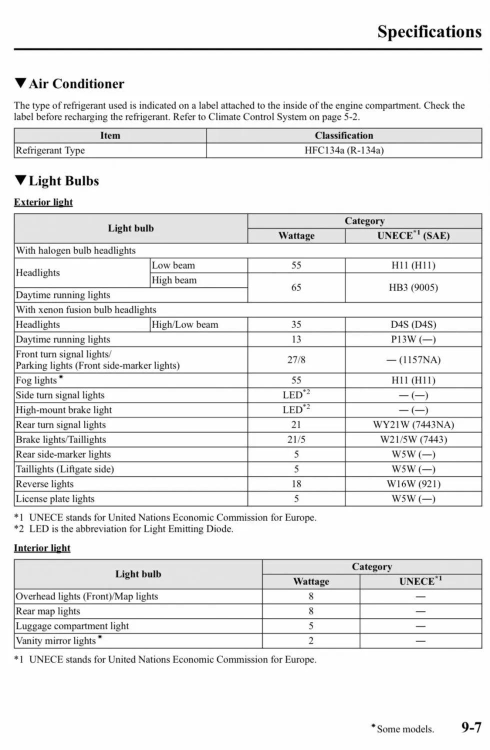

They’re in your owner’s manual, although the rear turn signal lights should be signal filament 7440NA:
Remember the owner’s manual also has bulb replacement instructions in detail.

@yrwei52; I need to use an "additional resistor" for turn signals? I don't even know what that means.... Time to start reading up on how all this stuff works! Just read up on it, and now I know something new! And I can't believe that the light bulb info was right there in a chart. How embarrassing... I looked in the manual and missed that. :unsure:
