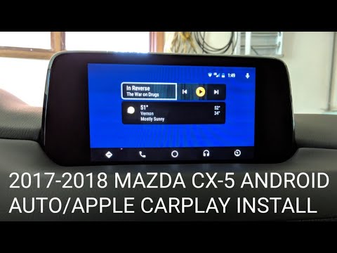

Watch this video, it helped me with installing. As jakeuten said, you need the proper firmware first.
