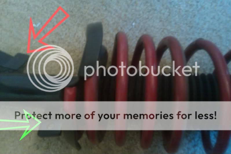

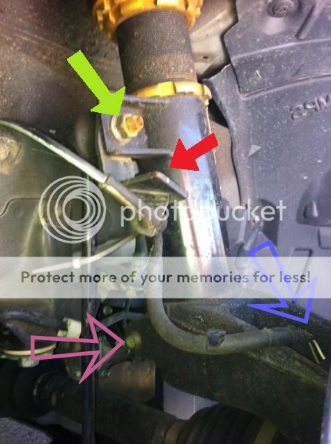

Okay here we go. And I am not at fault for any damage any one does to their vehicle. This is a brief overview of how I change springs and is not to be considered as a professional guide. Let it help you, but dont blame me if you muck it up. refer to pictures as you go along.

2: Remove the ABS sensor from right behind the rotor inside the lower control arm(LCA). (PIC 2 Blue arrow)
3: On the forward portion of the strut there is a bracket for the brake lines (PIC 1 red arrow)

4: On the rear (aft) portion of the strut there is a endlink bracket (PIC 1 green arrow and picture 2 red arrow)
A: Using a open ended or box wrench undo this with a 5mm allen holding the bolt in place take the nut off (PIC 2 green arrow)

5: On the back side (interior to the center line of the car) there is a huge bolt that clamps the C-clamp style strut bottom around the strut(PIC 2 purple arrow)
